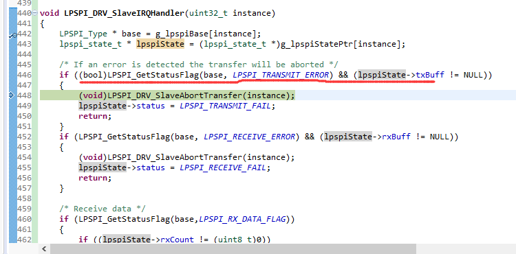

Dear all:
Enable interrupt mode, is it normal for interrupt to enter here?
Only after multiple runs can the data sent by the host be received completely correctly.
The main machine adopts lpc1769.
What's the reason, please?

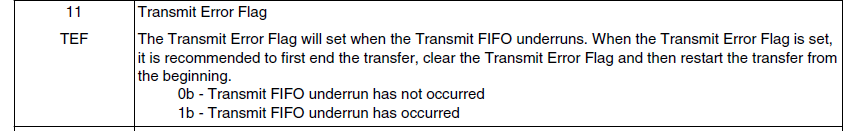

In your case, the FIFO underrun error was detected. That is why the transfer is aborted such as is recommended in the S32K RM rev12.1
At first, you can try to reduce the master SPI clock.
If I understand well your slave device is S32K116 and the master device is lpc1769, right?
