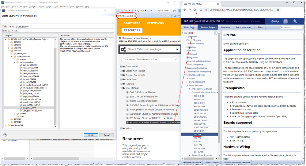

Robin_Shen
Hi Nhuan Huynh Duc,
Please download the latest S32 Design Studio for ARM 2.2 – Windows/Linux(REV 2.2), then you can refer the spi_pal_s32k144 example.
Robin

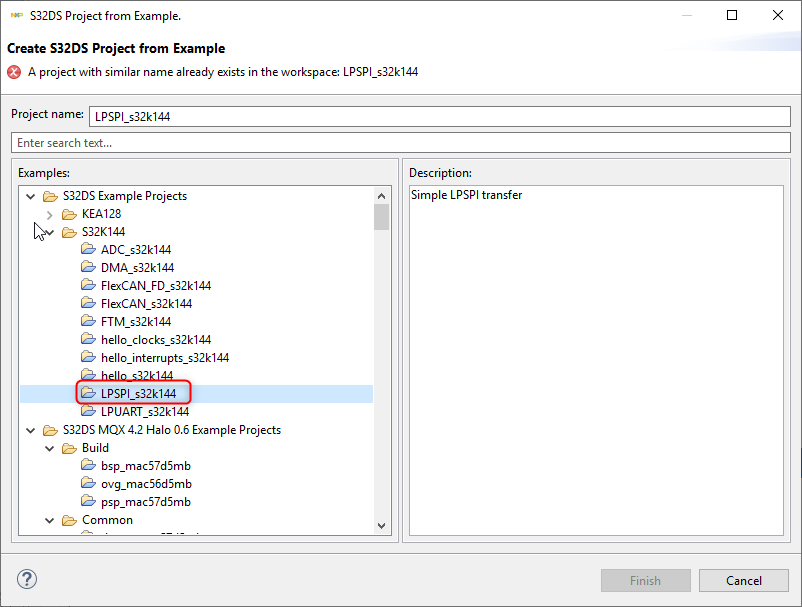

nhuan_huynhduc2
Hi Robin,
I have already referred to this example, but it's not suitable for my case.
Do you have an example is similar to LPSPI_s32k144 ?
Thank you

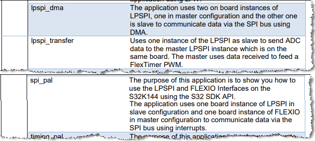

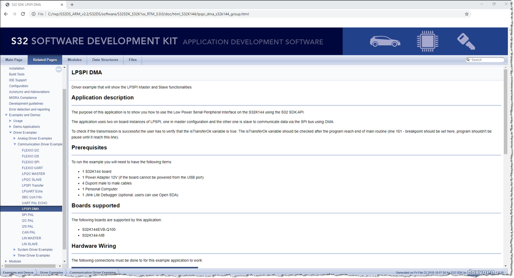

Robin_Shen
There are only three lpspi examples in S32SDK S32K1xx RTM v3.0.0:
It seem that there is no LPSPI_s32k144 example in S32 Design Studio for ARM 2.2.
