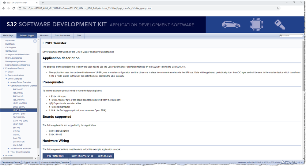

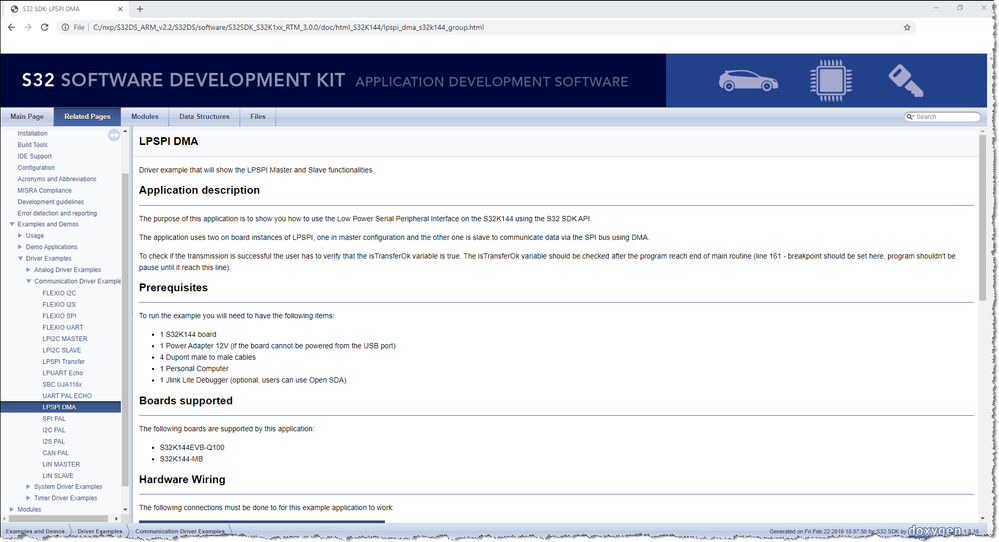

Robin_Shen
There are only three lpspi examples in S32SDK S32K1xx RTM v3.0.0:
It seem that there is no LPSPI_s32k144 example in S32 Design Studio for ARM 2.2.
