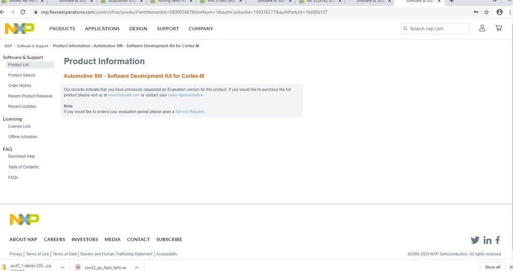

i Downloaded S32K142 sdk.
On the middleware folder i didn't find sdcard example.
can you please guide me!!!!
Thanks in advance!!!!

lukaszadrapa
the message talks about SDK for Cortex M. That's definitely not SDK for MPC5748G.
SDK for MPC5748G is included in S32 Design Studio for Power architecture:
https://www.nxp.com/design/software/development-software/s32-design-studio-ide/s32-design-studio-for...
Lukas

lukaszadrapa
S32K1xx devices don't have SDHC module. It was not expected use-case, so we do not have such example or drivers for this device.
If you are going to use SPI mode, you can use some general drivers where you can port SPI layer only.
And if we are talking about automotive devices then MPC5748G have SDHC module and it's supported in SDK:
https://www.nxp.com/products/processors-and-microcontrollers/power-architecture/mpc55xx-5xxx-mcus/ul...
Lukas

Teja114
unable to download MPC5748G  sdk .
can you please help me on this
