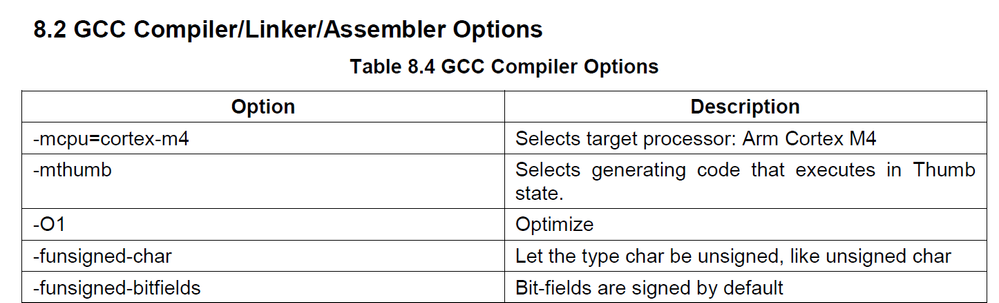

danielmartynek
The information can be found in release notes.
