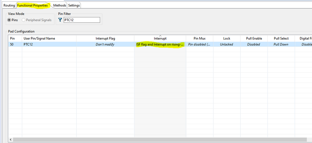

razva_tilimpea
You can use ProcessorExpert-PinSettings to skip this line:  PINS_DRV_SetPinIntSel(PORTC, 12, PORT_INT_RISING_EDGE);

pritampatil
Tried that too..
Still getting same warning message
