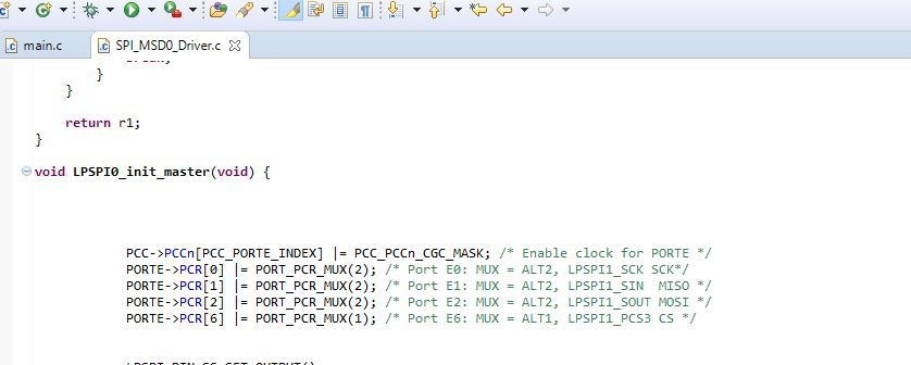

Teja114
Hi @Mrudula ,
please find the attached image ..
for the CS pin check out pin mux configurations i mentioned it as a PORTE->PCR[6] |= PORT_PCR_MUX(1); /* Port E6: MUX = ALT1, LPSPI1_PCS3 CS */. iam using CS as a GPIO pin .
if you want to use as a dedicated chip select PORTE->PCR[6] |= PORT_PCR_MUX(2); depending on your pin configurations ...sd_card_pins.JPG

rathi_tg
Hi @Teja114
The file which you have shared is very helpful.
But, I made few modifications as a part of experiment.
Basically, I changed the Configuration of the pins as follow:-
PCC->PCCn[PCC_PORTC_INDEX] |= PCC_PCCn_CGC_MASK; /* Enable clock for PORTB */
PCC->PCCn[PCC_PORTA_INDEX] |= PCC_PCCn_CGC_MASK; /* Enable clock for PORTB */
PORTC->PCR[15] |= PORT_PCR_MUX(2); /* Port B14: MUX = ALT3, LPSPI1_SCK */
PORTC->PCR[0] |= PORT_PCR_MUX(2); /* Port B15: MUX = ALT3, LPSPI1_SIN */
PORTC->PCR[1] |= PORT_PCR_MUX(2); /* Port B16: MUX = ALT3, LPSPI1_SOUT */
PORTA->PCR[15] |= PORT_PCR_MUX(2); /* Port B17: MUX = ALT3, LPSPI1_PCS3 */
PCC->PCCn[PCC_LPSPI2_INDEX] = 0; /* Disable clocks to modify PCS ( default) */
PCC->PCCn[PCC_LPSPI2_INDEX] = 0xC6000000; /* Enable PCS=SPLL_DIV2 (40 MHz func'l clock) */
"All the LPSPI0 are replaced with LPSPI2" in SPI_MSDO_Driver .
The Cord Builds fine without any error but no data is written on the Sd card.
Output on console is "Write Error 3".
Could you Even Throw light on Data Reading From Sd card.
Thanks in Advance!!!
Gopal Rathi.

Teja114
Hi @rathi_tg ,
please check the pin configurations first.
Did you changed the pins on reading the datasheet ?
Is the PCR_MUX is '2' ? or something else ?
cross check the code with  datasheet .
Teja..

Teja114
Hi @rathi_tg ,
i went through the file , everything was looking fine.
please check the connections from sdcard module to board .
And the supply voltage should be 3.3v.
if you're using sdcard module it is having 5v to 3.3v  regulator , must give 5V as a input .

rathi_tg
Hi @Teja114
If I amusing the Configuration which you have specified everything works fine. But, as soon as i change the pin configuration I am unable to read or write the data.
I have tried various combinations of pins as well as LPSPI but was not successful.
Could you please once change the Pins to other Configuration Lets take LPSPI2 and burn the code and let me know if it was successful.
I have Tried the same using LPSPI0, LPSPI1 and LPSPI2.
Thanks in advance.
Gopal Rathi.
