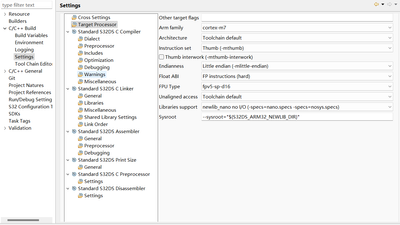

hi, i need help ,the problem occured when building the project. The error message is as follows,

I solve the error, because S32DS is not configured correctly. I configured the target Settings to fix this error. the target config as follows.
