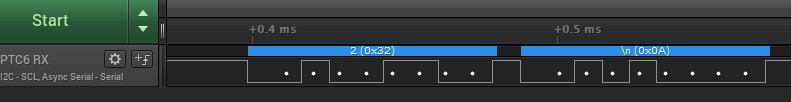

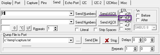

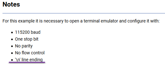

danielmartynek
Hi [email protected],
Please refer to the SDK documentation in the SDK installation folder:
.../NXP/S32DS_ARM_v2018.R1/S32DS/S32SDK_S32K1xx_RTM_3.0.0/doc/html_S32K144/edma_transfer_s32k144_group.html
I tried with RealTerm and it works as expected,but there needs to be the \n line ending.
BR, Daniel

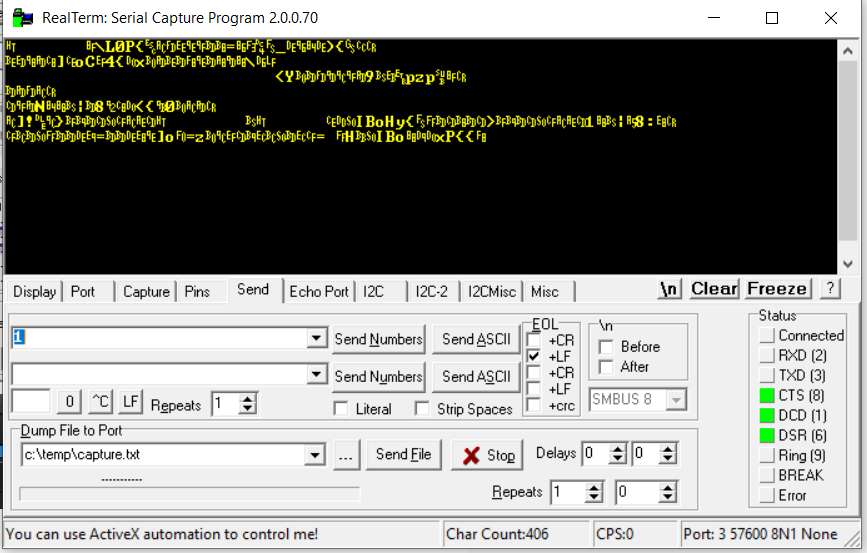

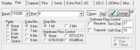

c_joshi
Hello Daniel,
I tried the same with Realterm and i get the following
2,186 Views
c_joshi
Hi I got it working, there was a problem with the wires. Thanks for your quick response and help.
