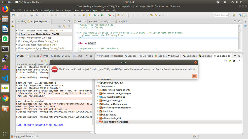

I've a MPC5748 DevKit and I'm working in Ubuntu 18(x64).
IDE: S32 Design Studio.
In this IDE when I was add tcpip stack component then tcpip stack not include.
and got a following error :
and I'm working in Core : Z4_0.
Kindly tell what should I do for add tcpip stack component into my current project ?
Thanks & Regards,
Pratik Panchal
1,485 Views
jiri_kral
based on release notes - SDK is fully supported on Windows host only. Under linux some components aren't working properly.
