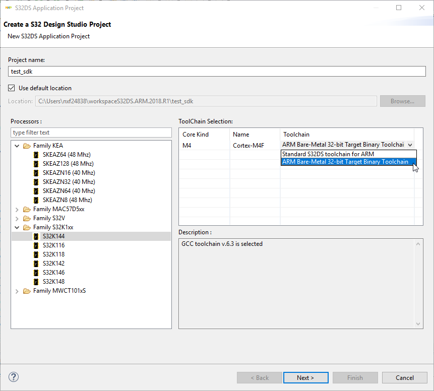

However, if I create  a new project by File->New->S32DS Application Project, I cannot choose the RTM2.0.0.
If I open the file dialog at line "SDK", I only get Version 0.8.6 listed. No way to specify 2.0.0.
RTM is installed, I can see it in the Help->Installation Details Menu.

jiri_kral
just select bare metal project in New project settings:
Hope ti helps.
Jiri

albrechtmichael
Hi Jiri,
that helped. :-)
Thank you very much for your effort.
