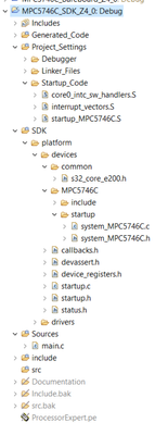

I develop MPC5746C with S32DS and SDK, but in the project I have configured, I can't find the files such as "flashrchw.c", "intc_sw_handlers.S", "intc_SW_mode_isr_vectors_MPC574xC.c", "MPC57xx__Interrupt_Init.c", "Vector.c". How to get this files in the SDK or how to configure it?

the project structure is a bit different when project is created with SDK enabled. Please check the Startup_Code folder in your project:
flashrchw.c is basically implemented in startup_MPC5746C.s where RCHW is defined.
intc_sw_handlers.s exception handlers are implemented in  core0_intc_sw_handlers.s
intc_SW_mode_isr_vectors_MPC574xC.c  is defined in startup_MPC5746C.s see label __isr_vector:
MPC57xx__Interrupt_Init.c is partially implemented in S32_core_e200.h
Vector.c has been transfered into interrupt_vectors.s
Please check the files and let us know which specific function you are missing or what is your goal.
