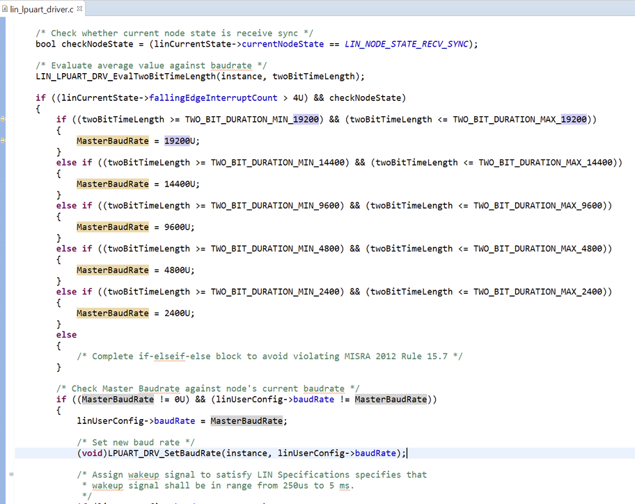

LIN Bus客戶 要求 baud rate = 10417 bps ,
使用 LDF Explorer 亦支援 10417 baud rate :
但是,回到 S32DS , LPUART2 並不支援 該 baudrate  :
現在 設備無法溝通, 不確定 是否是 LPUART baud rate 設定造成 !?
有人 能協助確認 嗎?
感謝
S32K144 EVB + S32DSv3.5+RTM401

You could consider upgrading to RTD 3.0.0, which is more flexible in the LIN Baud rate, see below.
Please note that the legacy SDK 4.0.1 that you use is no longer supported and is not recommended for new designs.

Unfortunately, the driver supports these fixed baud rates only:

But my customer ask to use the strange baudrate ...
And [LDF explorer] support this strange baudrate too...
I support it's ok for this case, and promise the customer on go this case already .
So, What can I do now ?
Any comments?
Thanks for any comments ... or gossip
