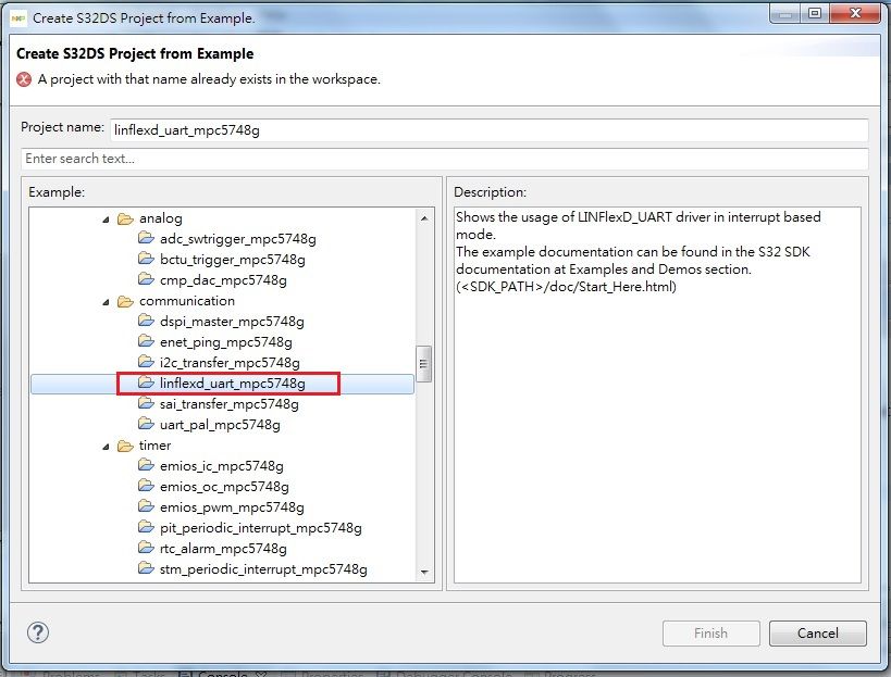

barkly_lin
Hi Jiri
It seems clock source and INST_LINFLEXD_UART10 are the problem, because I created another project by "New\S32DS Project from Example\linflex_uart_mpc5748g", and its UART works.
I use the same pinmux/clock source/INST_LINFLEXD_UART10 with both of projects.
The project as attachment "linflexd_uart_mpc5748g.zip"

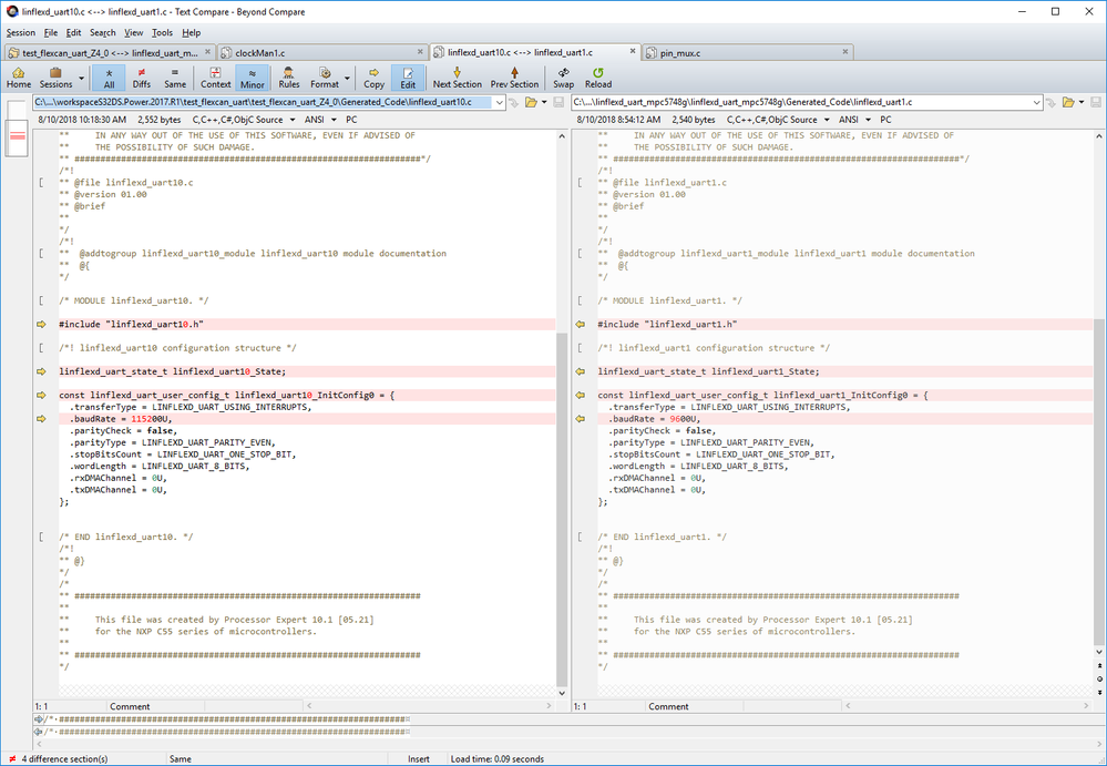

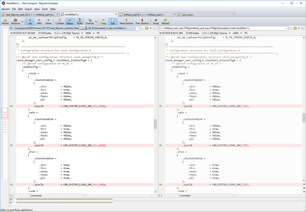

mikedoidge
Hello [email protected]‌,
After comparing the generated Processor Expert Code, I can see that there are a number of changes which need to be made inside Processor Expert.
In Clock Manager
In LINFlexD/UART
In Pin Mux

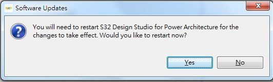

I also noticed you are using the S32 SDK MPC574xx EAR 0.8.1, I would recommend that you install the update ( S32 Design Studio for Power Architecture 2017.R1 - Updates 5 and 6 available) and use the latest S32 SDK MPC574xx RTM 1.0.0

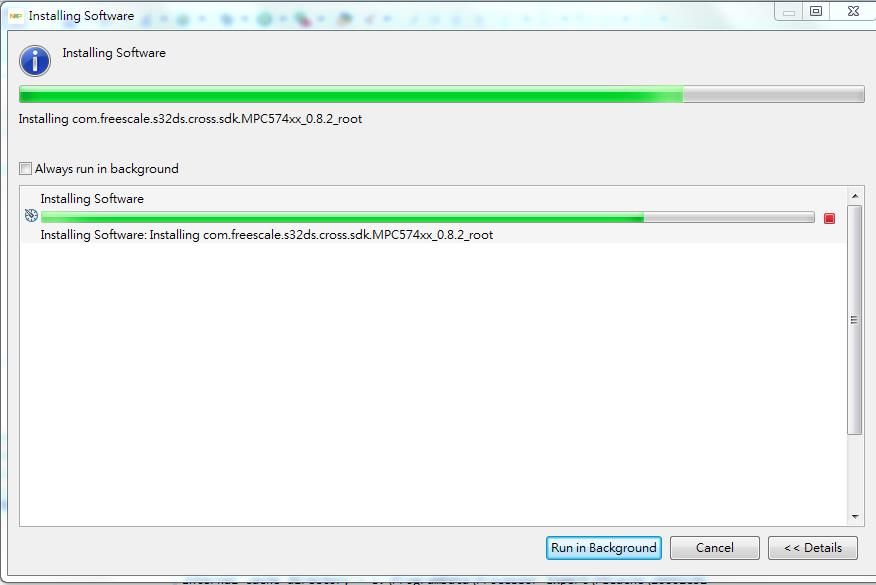

barkly_lin
Hi Mike
It is still not working after modified clock source & INST_LINFLEXD_UART10.
When I try to do "Install new software" with S32DS_PA_v2017.R1_UP5_UP6.zip in S32DS.
System stuck here.

mikedoidge
How long did you wait to see progress? Depending upon your connection speed, it could take some time. I have seen this take longer than expected on another customer's PC.

barkly_lin
Hi Mike
I wait more than 1 hour, my connection speed is acceptable because it's smooth for downloading S32DS_PA_v2017.R1_UP5_UP6.zip(> 1GB).
Should I have to wait overnight?

mikedoidge
Hi [email protected]‌,
It should not take so long to install, especially since it appears you have downloaded the file from the NXP website prior to installing. Are you seeing any error messages? Is there a dialog window somewhere that is expecting a response from you? Have you tried relaunching S32DS and starting the update again? Do you have an active debug session running when you performed the update? I sometimes forget to end those.

barkly_lin
Hi Mike
When update process stuck again, just leave it overnight, then I saw it finished this morning.
I created a new project based on S32 Design Studio MPC574xx SDK RTM 1.0.0.
Now FLEXCAN_DRV_xxx()s are working well, message come out from UART success.
