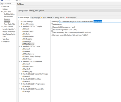

 when called Z7CoresInit() inside main() of Z4 cannot build the project.
getting a error : real-ld.exe: ./SDK/middleware/rsdk/platform_setup/src/PPC/gen_sdk/platform_setup_sdk_sa.o: the target (C1_CODE_START_ADDR) of a R_PPC_VLE_SDA21 relocation is in the wrong output section (*ABS*)
but when using a address location instead of  'C1_CODE_START_ADDR', not getting any error.

burak_
I solved the problem with your guidance.
this is my flags after adding disable SDA :
-c -fmessage-length=0 -fstrict-volatile-bitfields -mlra -msdata=eabi -mno-sdata
I removed last 2 command (-msdata=eabi -mno-sdata) and not getting any error. BTW, it  also builded with -mno-sdata.

stanish
Hi burak_,
What version of S32DS are you using?
Could you possibly try to add the option to disable Small Data Sections (-mno-sdata) -> basically disable creation of SDA21 relocation as a workaround? Please note that this should have some impact on speed performance.
