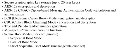

Hi guys, any resources could be helped to deploy a encryption method on s32k144 board?
use AES algorithm to encrypt/decrypt the data
use RSA to encrypt/decrypt the AES public key
SHA-1/MD5 use to hash the transmitted data for integrity check
it's a master project to implement this cryptographic method on the develop board for connected vehicles

features supported by hardware / CSEc are:
We provide this application note about the CSEc:
https://www.nxp.com/webapp/Download?colCode=AN5401
https://www.nxp.com/webapp/Download?colCode=AN5401SW&docLang=en
If you need other features not supported by hardware, you can take a look at WolfSSL which is included in S32DS SDK package:
https://www.nxp.com/design/software/development-software/s32-design-studio-ide/s32-design-studio-for...
Lukas
