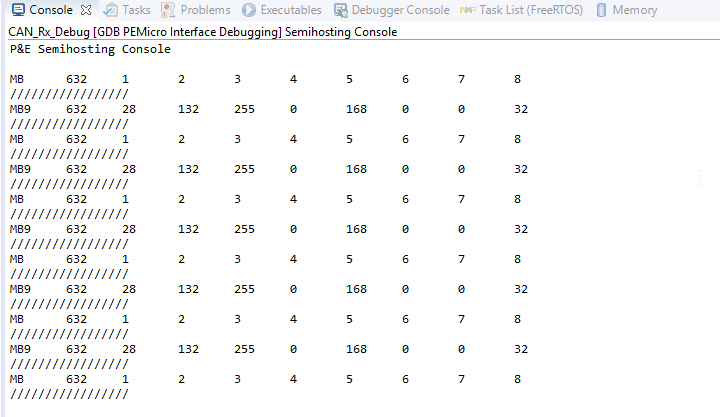

I tried your TX code - left only very first row in ISR handler - and there is no issue. I can get both messages:
void LPIT_ISR (void)
status_t st=0;
LPIT_DRV_ClearInterruptFlagTimerChannels(INST_LPIT1,(1<<0));
st=FLEXCAN_DRV_Send(INST_CANCOM1, MB9, &dataInfo1, MSG_ID, (uint8_t *)&BmsStatus10); //632
st=FLEXCAN_DRV_Send(INST_CANCOM1, MB, &dataInfo, MSG_ID, (uint8_t *)&BmsStatus1); //632
Here is full output:
With the only two messages - there is no issue - but - you can't rely on this.
To be sure that transmitted message from MB9 ends in MB9 on receiver - you need to specify ID. With the same ID - the message can end in MB0 or MB9 - depends on traffic - if I understand it correctly. Anyway - what is your use case to have the same ID for different messages?
Jiri

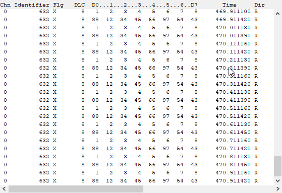

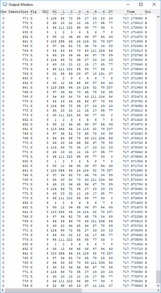

sushma
Hello Jiri,
This means that my code is working fine, but I'm not able to see it on my console(along with all my other message with different IDs). This would be solved by using CAN analyzer, right?

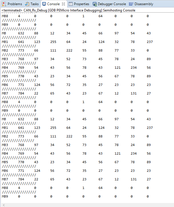

actually - your code as it is is not working okay. the The very first MB data are rewritten by MB9, and MB9 is empty - because of the same Message ID. Here is output from unmodified code:
With two messages only it is working... somehow. But as I mentioned above - to be sure that you get all messages in proper MB - you need to specify unique ID for each message.
