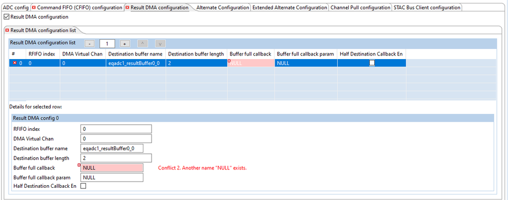

I think there is a bug in the user input validation of Processor Expert for S32 SDK 3.0.3.
In the eQADC component fields, there is a possibility to specify callbacks upon DMA transfer completion. Since I do not want this behavior, I specify "NULL" in these fields.
However, the validation understand NULL as the name of a callback, and it will not let me use it in more than one place: it flags an error stating a name clash.
I did not check but maybe the same problem exists for other ProcessorExpert components as well.
Is it possible to get a fix?

Could you solve the problem?
I am having the same issue while defining multiple I2C master configurations. I cannot define more than one callback as "NULL".
