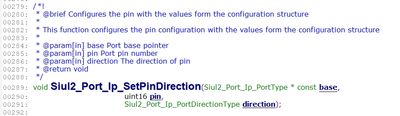

So if I set a GPIO direction as 'Input' in the pin configuration. And I want to change its direction to 'Output' at some time during the program is running.
Should I use the API below?
If so, should I set the 3rd param as 0 or 1 for 'Output'? Is there any manual about this?

yes ,you can use this function to change GPIO direction.
you can read this function then you will easily find that,set 0 ->In,set 1->Out
