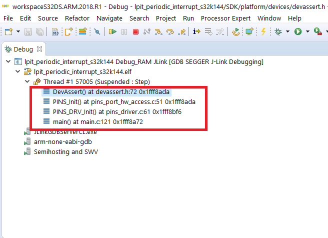

in S32k design studio for ARM v2.0 how do I open then "call stack" window? I am using a segger J trace pro

S32DS displays call stack in the Debug View. Unfortunately it does not allow you to examine complete stack frame - it is good for call tree.
You can copy &paste this information using ctrl+C on an item and paste it as a text into a file if you want.
