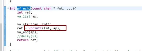

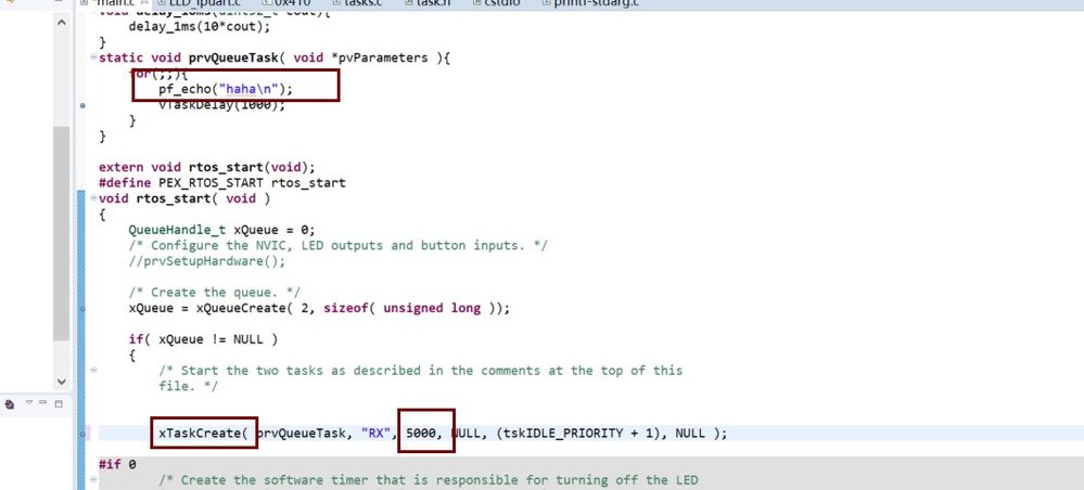

3. I used library of EWL . If I used lib API of "vprintf" in a freertos task ,the system  will be crash. whatever the heap size  that I give to this task (I most give to 5K). If I haven't used in freertos task is ok
So could you tell me how to solve it.

the third issue,I have already solved it. it's because  that I forgot to initial uart module
