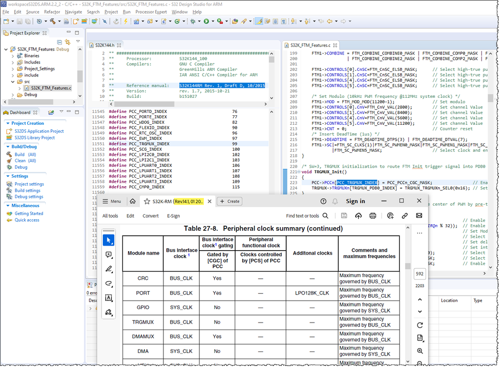

I have read the S32 RM regarding the PCC configuration registers. My observation is the TRGMUX peripheral does not have the PCC_TRGMUX_INDEX. Hence the compiler could not detect.

Robin_Shen
Hi Kapila,
Thank you for your hint.
I didn't check the reference manual carefully before, I only looked at AN5303SW\S32K_FTM_Features\src\S32K_FTM_Features.c and didn't realize that the header file used by this project is too old (S32K144RM Rev. 1, Draft D, 10/2015).
After checking the latest S32K1XXRM Rev.14.1, I agree with you. TRGMUX is not gated by PCC[CGC]. PCC_TRGMUX_INDEX does not exist in the new header file used by your project, so an error occurs.
Referring to the trgmux_lpit_s32k144 example in S32K1 SDK 4.0.3 in S32DS v3.4, there should be no need to enable the clock through PCC[CGC] like other peripherals.

Robin_Shen
There is no need to enable PCC clock in TRGMUX_init(). The ARM Cortex M4 core does not contain PCC configuration register.
If you are using S32K1 SDK in S32DS, just call INT_SYS_EnableIRQ(IRQn_Type irqNumber)
