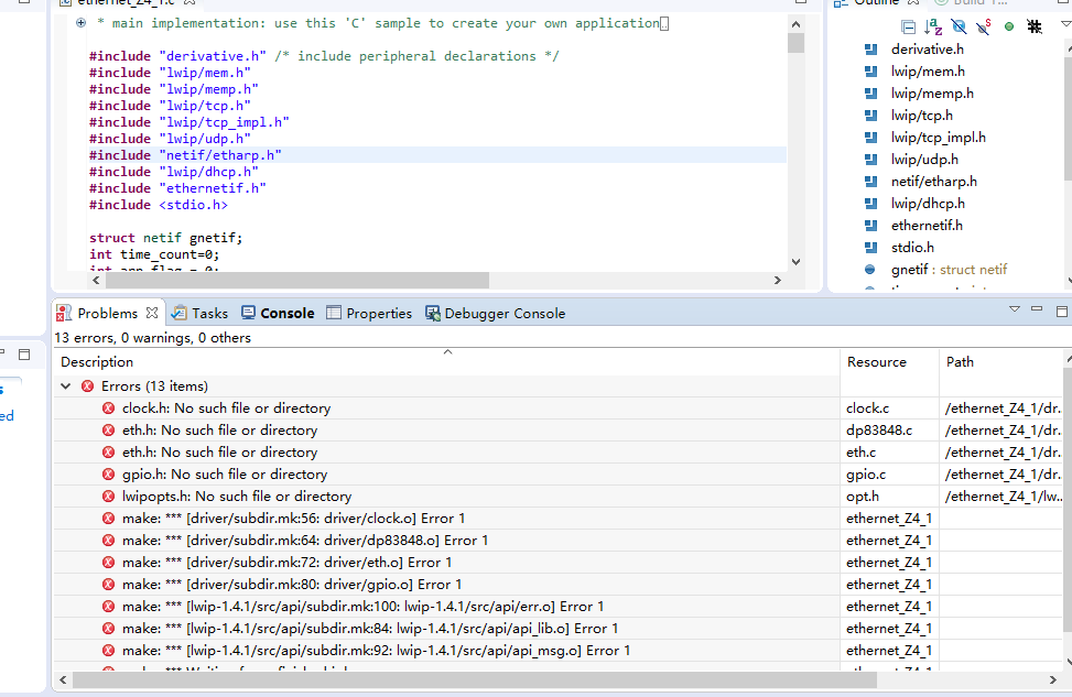

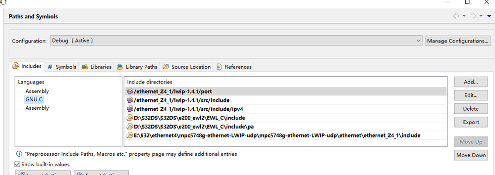

I try to debug the lwip example for many times. But it always tells me that there are different errors. When I get the example project, I change the include route as follows.
If I add the last path into the route, the S32 say it cannot detect my device when I debug.
if I do not add the last path, the S32 says it cannot find lots of files.
I do not know why and I just change the route. I wonder if I should change any other settings to debug it or do something. I really have no ideas to solve it. Anyone have some good solution to solve it ?

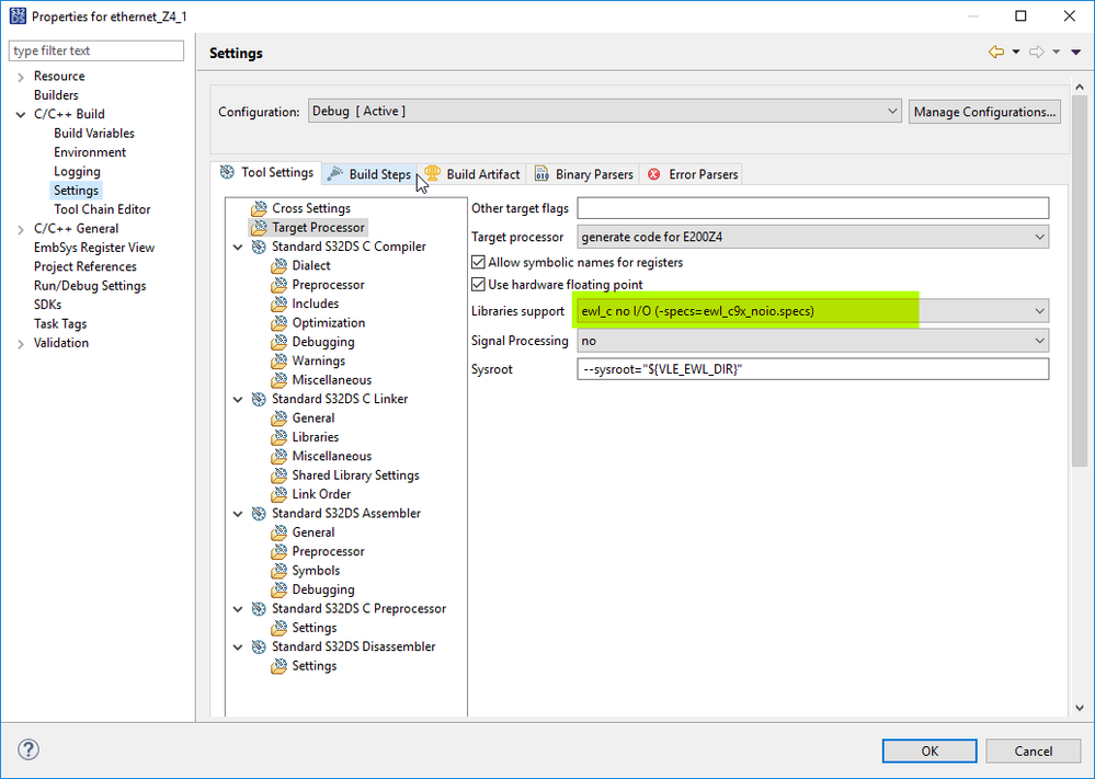

I tried your project. With EWL nano it can't be built. I replaced EWL nano with standard EWL library and there is no issue with build:

In your project are two issues. First one - project can't be compiled if EWL Nano C Library is used. This can be fixed if you switch C library to EWL.

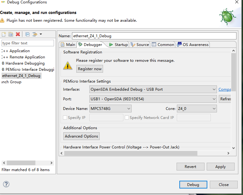

Second "issue" is - you have OpenSDA debugger on your board and you are trying use PE Micro Multilink FX probe - which is standalone hardware probe from PE Micro - Multilink FX | Advanced High Performance Debug Probe | PEmicro  . OpenSDA Embedded debug is right choice in debug configurations.

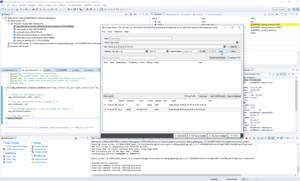

For the EVB, I use MPC5748g as my board. Changing library can solve the first issue, it make compile succeed without errors. This example is from MPC5748G ENET , the right result is in Yue Li's user guide (the attachment). Then I try to debug the project, the projected can be debugged. But when I try to send ethernet packet, it will not send me the same one. I wonder if you have the same problem when you debug this example project.

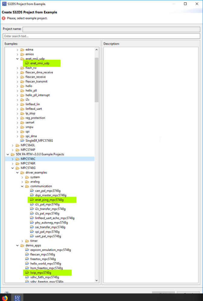

unfortunately this example is for MPC574xG Mother board and Daughter card  ( Evaluation System for MPC574xB/C/G Family | NXP  ). With this configuration example works as expected:
Anyway - as a part of S32DS Installation - there are Ethernet examples:
Hope it helps.

I changed the library as same as you. Then the issue is solved. But the debug interface which is used in my project is OpenSDA interface. I wonder if there is some differences between the OpenSDA and the USB Multilink ?
