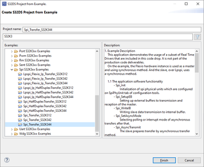

how can i get the sample code of Qspi for s32k3xx.
i imported the s32k344 sample code from the RTD 2.0.1,But i am not able to add the peripheral's

The peripherals are added using the Peripherals Tool. The QSPI Tool that you show in the images is an advanced tool which can be used to create customized parameters for the QuadSPI to be used by the BootROM. This is not supported for S32K3xx family of devices.
The available example applications are provided in the New Project from Example wizard:
For specific details on the availability of QSPI example, I refer you to @namnguyenviet for further details.

At this point in time, S32DS 3.5 is not broadly supported on the S32K3 family. We do recommend to stay at version 3.4 until further notice.
