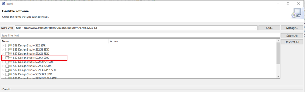

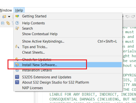

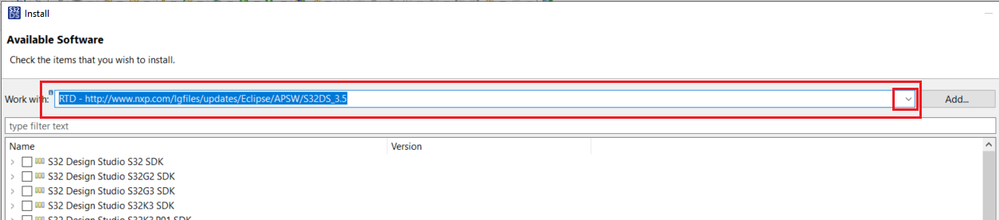

Till it is available, you can get the S32K3 SDK by following these steps:
1. Select "Help", then "Install New Software "
2. Then from the opened window, for "Work with" option - select the RTD from the drop down menu,
3. Then select the S32 Design Studio S32K3 SDK
Then you can install the S32K3 SDK.

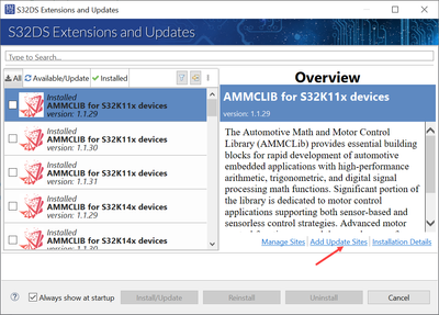

Hi @Anjalipurushothaman
Correct me if I'm wrong, but what I understood was delivered a .zip file which is an update site for S32DS.
These files are installed as follows:
Selects the DS_updatesite.zip you want to install.
Then in the same S32DS Extension and Updates tab you have to look for the update site you add previously select it and Install/Update.
With this, you should be able to use the software.
