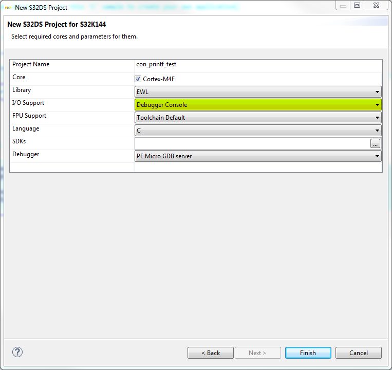

jiri_kral
if you want use printf only for debug purposes - you can set I/O support to Debugger console during project creation. Printf output will be redirected to debugger console.

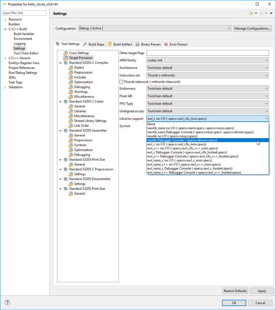

jiri_kral
you can switch the library with I/O support in existing project as well in project properties:
Hope it helps
