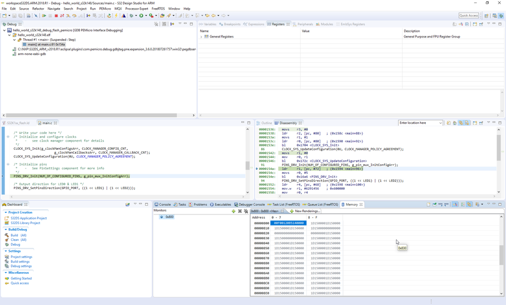

      i use SDK S32K148 ,build a project.when I try modify the link file. the program not work,and the reset is alway low.
      i think the problem is link file.pls look  pictrues.
       some chips have boot header. has S32K use it like boot header?

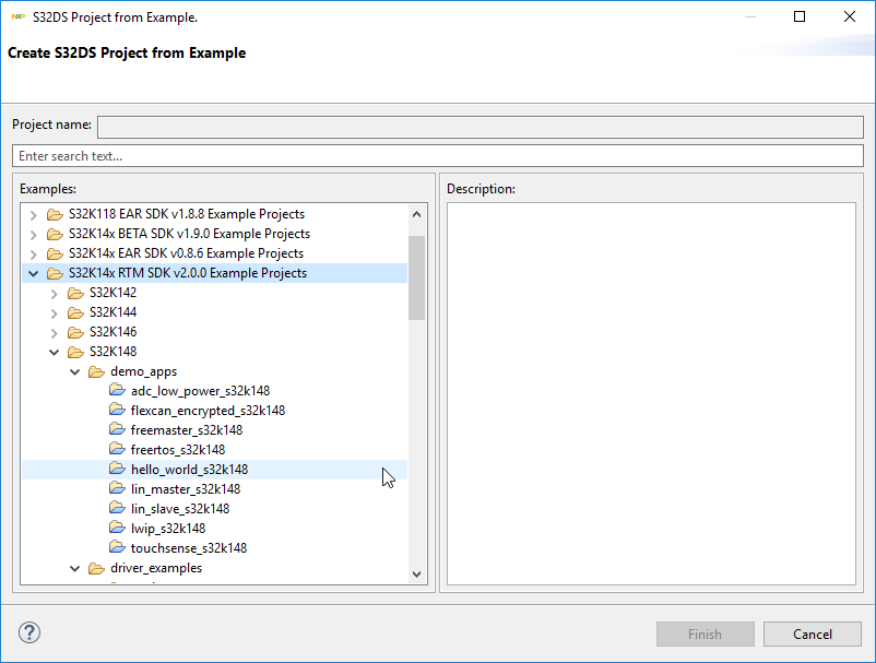

   I only use S32DS project from Example.<hello_world_s32K148>,when i put vector table to 0x0000 0000 - 0x0000 0400, the program is OK , when i put vector table to 0x0000 0800 - length = 0x0400.The program is not ok.
and i have a question,what is the different[.section  .vector,"a",%progbits] and [.section .vector ].
thanks a lot.

attached project is not complete - there is missing debug session, Processor Expert and may be some other stuff.
Just delete it - and open new one:
As you can see - I moved Interrupt vector table to 0x800 and there is no issue:
Jiri

I only use S32DS project from Example.,when i put vector table to 0x0000 0000 - 0x0000 03ff, the program is OK , when i put vector table to 0x0000 0800 - 0x00000bff.The program is not ok. and i have a question,what is the different[.section .vector,"a",%progbits] and [.section .vector ].
