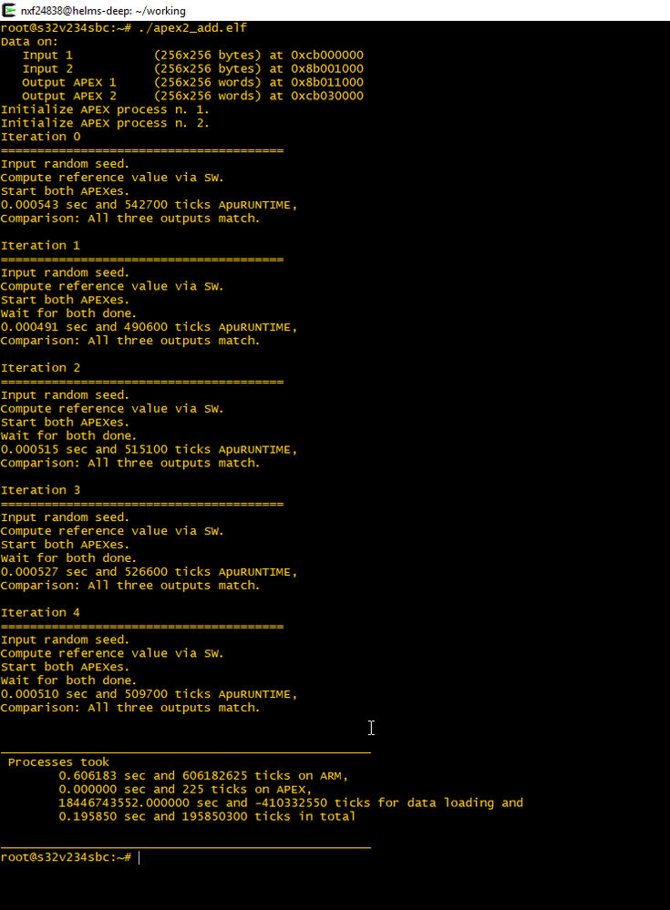

I create a project from apex_add example in s32 disign studio, and build elf file with A53_linux. run error:
APEX_InterruptSetup() -> ioctl 'IOCTL_APEX_PID_SET' for APEX 0 failed and returned errno Inappropriate ioctl for device
APEX_InterruptSetup() -> ioctl 'IOCTL_APEX_PID_SET' for APEX 1 failed and returned errno Inappropriate ioctl for device
APEX_InterruptSetup() -> failed to allocate memory for interrupt array

S32DS:version2.0 build id 170911
Device:s32v234_sbc
then, the APU firmware that I build with S32DS, should be place where in the filesystem?

there is new S32DS release - https://community.nxp.com/docs/DOC-342080
including RTM VSDK v1.2.0 fully supporting the SBC evb. The older VSDK has some issues related to SBC board. Please update your S32DS and OS image.

what is your S32DS version and EVB? I just built this demo (S32DS v2018.R1) and start it on s32v234_sbc board (running Linux BSP 18 HF) and have no issue:
Jiri
