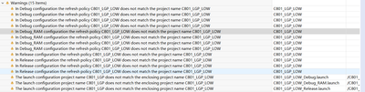

hi, my IDE is
S32 Design Studio for ARM
Version: 2018.R1
Build id: 180815
also have this bad problem. always warning in problem console.
I had check the prj names, it is sure correct.
still not solved....

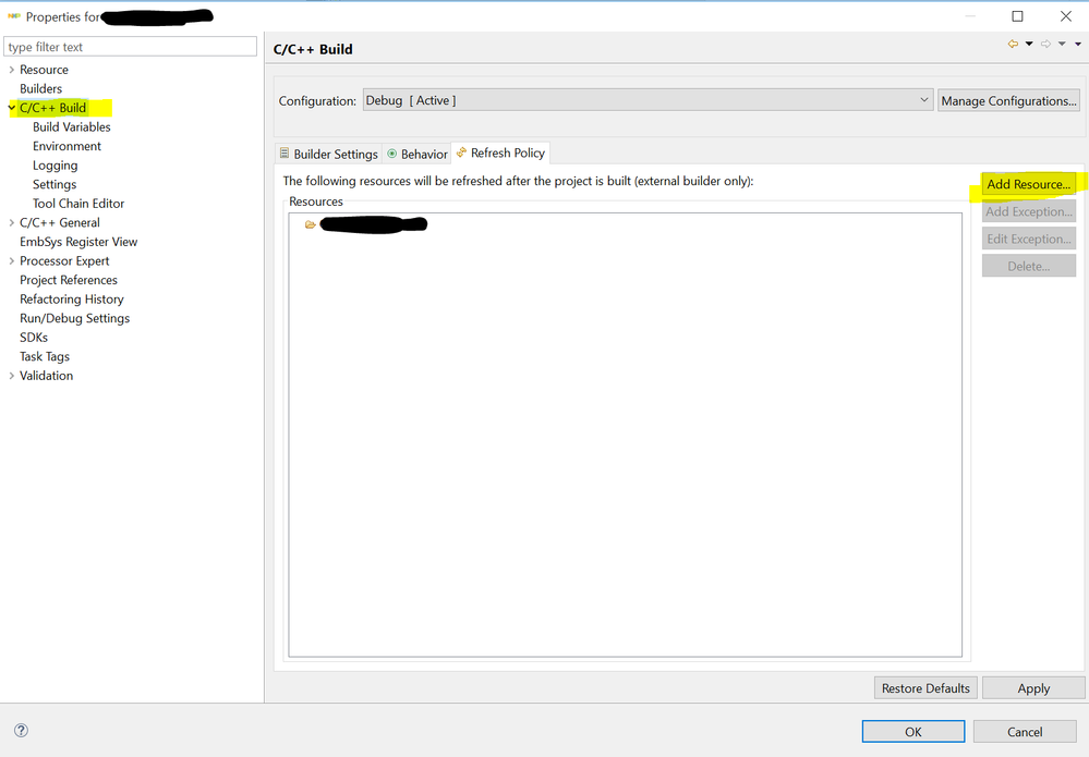

As you say Xu zhao, this issue is not resolved in S32 Studio.
When you duplicate a project S32 Studio fails to rename certain files and configurations.
You have to review all Debug Configurations for your project (right click on project > Debug As > Debug Configuration)
You will also have to review the Refresh Policy in each of your C/C++ Build configurations. Delete the wrong resources and add the proper ones

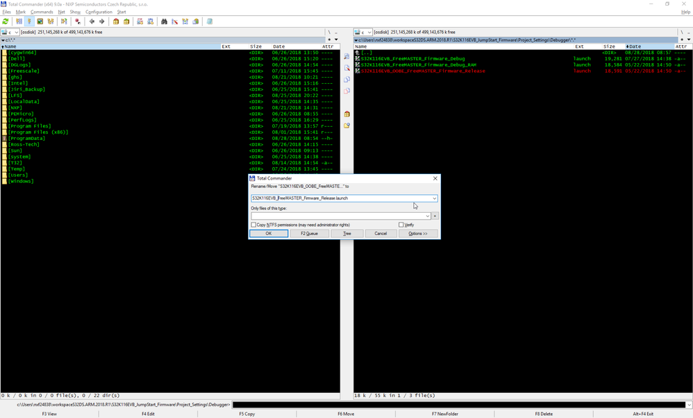

there are different names for .launch xml files - located in project root -> Project_Settings\Debugger. Just rename these files  to met the project name:
On screenshot I already renamed the first two files. In my case there was extra _OOBE_ in filename.
Hope it helps.
Jiri
