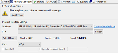

Anjalipurushothaman
Please find the procedure and the error getting when running.
while debug, when selecting open sda, port is not showing

VaneB
Hi @Anjalipurushothaman
I could not test it with S32K3X8EVB-Q289 because is still not available on the market. But I test it on a S32K344EVB.
Please try selecting in Debug Configurations tab the USB Multilink interface.

Anjalipurushothaman
debugging works fine with PE micro debugger(please find the attached)
Inorder to see the output(Blinking led project) run configuration tab while clicking gdb segger-j link(the hardware is open sda) configuration getting below error. any other alterante to run the project?
error:arm-none-eabi-gdb  (attached the error)
Running a project is the problem.

VaneB
The problem is that the S32K3 family supports SEGGER debuggers but, there are no scripts to use it.
30,888 Views
