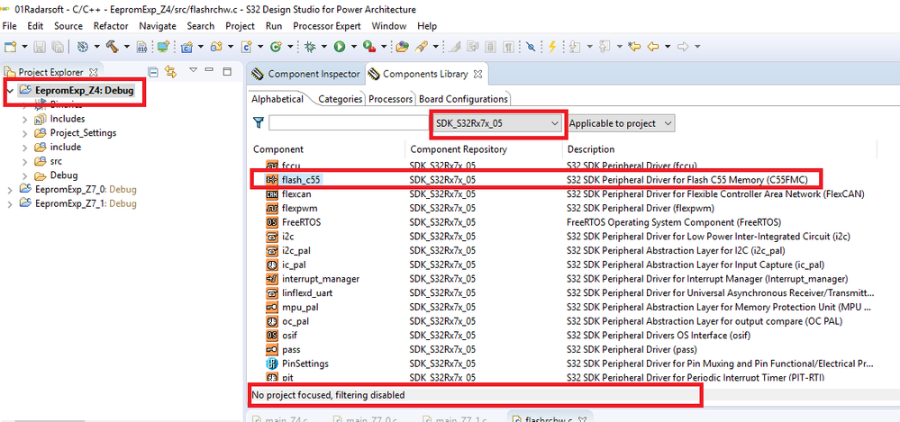

      Why cannot I add components of processor expert to the project of S32R274? the note is that " No project focused, filtering disabled".  following screenshot:

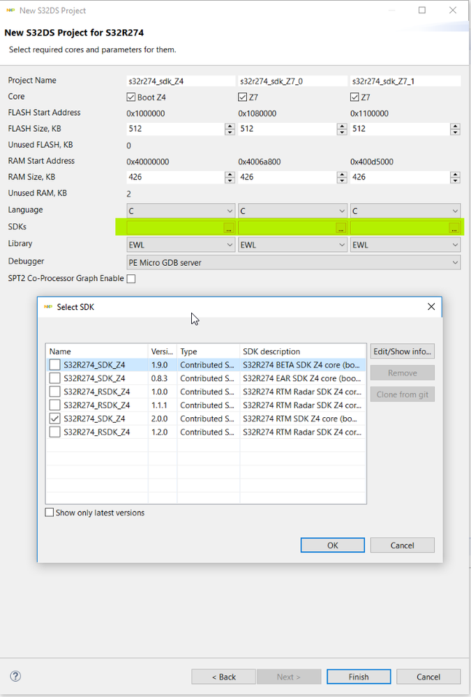

It looks that your project is not using SDK. You can select SDK in new project settings:
or attach SDK to existing project - right click on project name -> SDKs -> Attach/Detach SDK you are interested in to your project:
