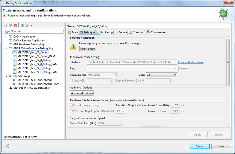

I'm trying to connect to perform ddebug on DEVKIT-MPC5748G EVA Board.
1. I've installed the S32 Power v1.2 SW toolcahin.
2. Plug in the board, its powers up and run the pre-programmed SW demo.
3. I'm looking in device driver and I see openSDA port is on COM8.
4. I'm trying to debug demo SW, when I want to change the dbugger used, all options are in greay.
any idea?
2,198 Views
stanish

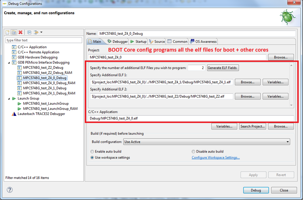

The only boot core (Z4_0) debug configuration can program the MPC5748G. Other cores cannot be programmed separately - this is the reason why the interface settings are grayed for Z4_1, Z2 and boot core programs all the elf files.

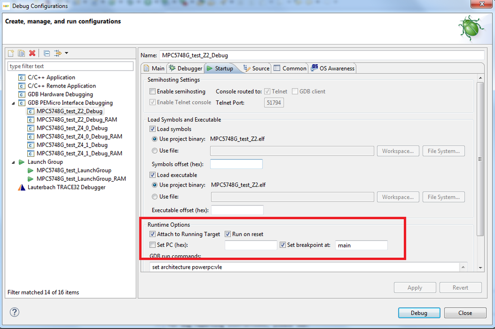

Other cores (Z4_1, Z2)  just attach to a running target programmed by the boot core and loads elf debug info for source level debugging.
For multi-core debugging please select the MPC5748G Launch group instead of a separate code debug configuration:
Hope it helps...
