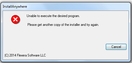

when I install S32 Design Studio IDE for Arm, I meet the following problem.
installation file is S32DS_ARM_Win32_v2.0_b170810.exe
my laptop OS is window7, 64-bit.
please help to check what happened and how to solve it. Thank you. 2017-11-01_092744.pngs!

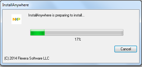

did the Install shield started extracting files or error message pop up right after execution? Are you able get lnstallation log file -> located in [YOUR_INSTALL_PATH]\S32DS_ARM_v2.0\_S32 Design Studio for ARM v2.0_installation\Logs\ ?

I check the Install shield can't started extracting files yet, when click the installation file, it enter into this below interface.
after a while, the installation is stopped at the following picture. 2017-11-01_092744.png

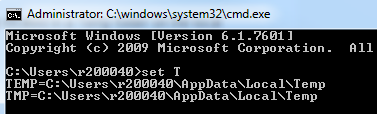

2) make sure that your TMP and TEMP folders are pointing to the same location:

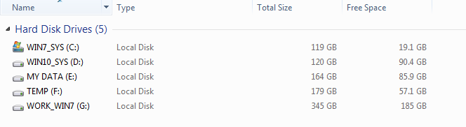

1, Disk space info as following, and my installed memory(RAM) is 8GB,   is it enough?
2, TMP and TEMP folders are pointing to the location as below:
