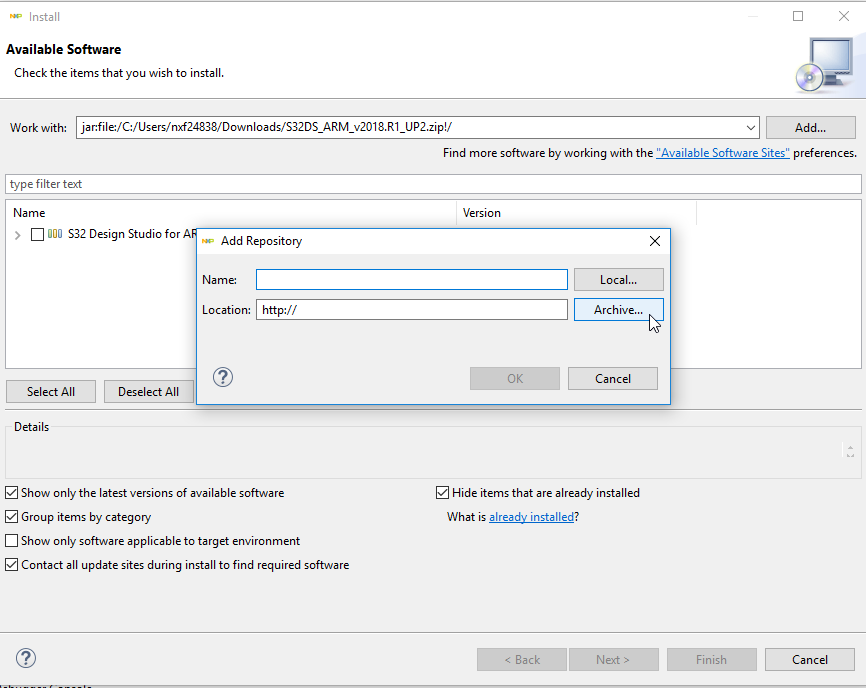

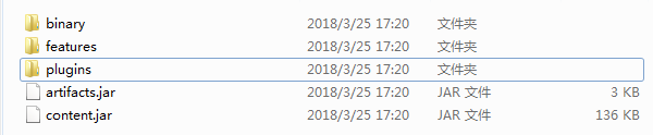

        Could you please tell me how to use the (S32 Design Studio for ARM® 2018.R1 Update 2 – S32K116 Device Support & S32 SDK EAR 1.8.7 for S32K116(REV UP2) NEW)  of S32 Design Studio for ARM 2018.R1?
        Which folder  location  should i put those extracted files?
       Thanks!

just click on main menu bar to Help -> Install new Software -> Add -> Archive and choose the Update zip file.
Final step - click on Finish button.
Hope it helps.
Jiri

The zip file is to be installed by the studio, not by copying file manually.
Follow instruction described here: java - Eclipse: How to install a plugin manually? - Stack Overflow
