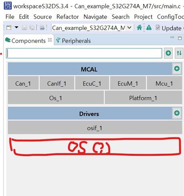

I have S32G-VNP-RDB2 board.
I develop Automotive G/W using S32 DS 3.4.
I followed some example documentation.
However, the example document and my development environment were different.
In the Components page of the example document, there were components of MCAL, Drivers, and OS.
But my S32DS doesn't have OS Component.
I want to know how to add OS components.

All of the components which are listed in the Peripherals Tools, are supplied by the Real-Time Drivers SDK package (RTD). The components available for each device may not be the same. Click on the '+' to see the list of available components which can be added.
Hope that helps,
Mike
