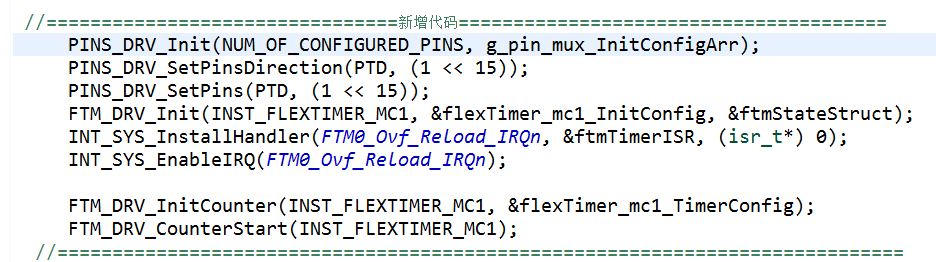

when I add some code for timer function and the adding code is the following picture ,anther part is  new a isr function ftmTimerISR。
the DS32 compiler report the following errors

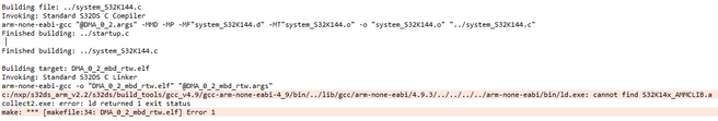

I tried the solution you suggested, but it seems not to be working. Do you have any other suggestion? The error that I am getting is the one shown below:
Thanks in advance!
4,795件の閲覧回数
jiri_kral

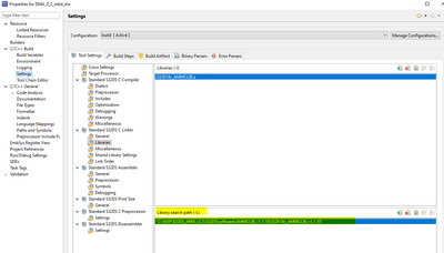

Looks, that linker can't find ammclib. Please make sure that you added correct path to ammclib into project properties:
Jiri
4,793件の閲覧回数
juliana_rojas30
Hi @jiri_kral , I truly appreciate your fast response.

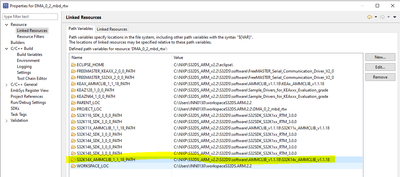

I had that Library space empty, so, I copied this path:
Into the space you pointed out. So, now it looks like this:
Then pressed "Built", but I am still getting the same error.
Note: What's written in the upper space (below Libraries (-l)) was there already.
Thanks again!

Hi @jiri_kral ,
I went and looked for the .a file directly into the simulink files and copied the path and worked (not the one that was in linked resources). I had some issues after that but I was capable of fixing the issue.
Thanks for your help!
