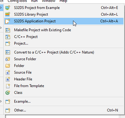

jiri_kral
you are trying run the target .elf file on your PC Machine - which is impossible. You probably create your project as a C/C++ Project instead of S32 Application Project:
For running it - you need to start debug session:

jiri_kral
using the C/C++ project is the wrong way - that's why you get the error. Correct way is use New -> S32DS Application project:
As a next step choose your MCU:
This procedure configure all project settings for you.

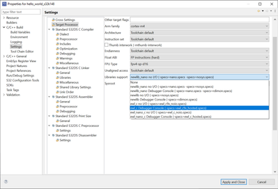

VaneB
Hi @Anjalipurushothaman
We do not recommend using printf and scanf. It is suggested to use the UART to print information with the MCU into a console.
Even so, if it is possible to use them, for that you need to use lib C with the Debugger console:
And the printf output is going to be shown in the Semihosting console.

Anjalipurushothaman
Traget processor option is not enabled here  ,
