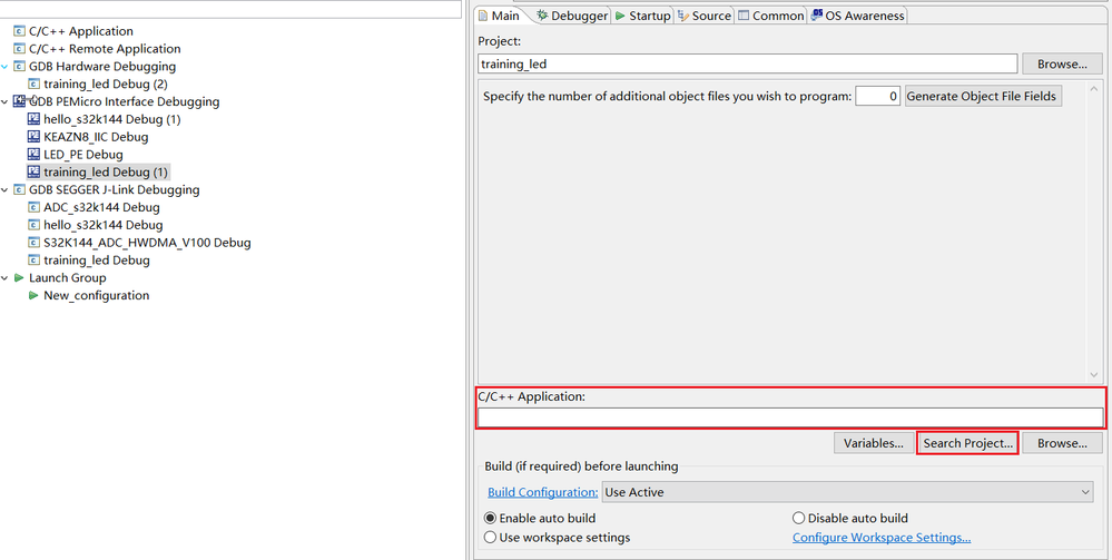

hello,everyone

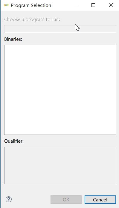

    I created a new project through flie-> new-> S32DS library project. After compiling, I couldn't find the corresponding .elf file in the debug interface, as shown below. Cannot find the corresponding elf file in the c / c ++ applicaation path.搜狗截图20200329215335.png
The usual project elf file is deleted and can be found through the search project, but the new project you created has no options. How do I set or find the corresponding elf file?

if you created new library project - your build target is library archive - libyour_project_name.a and is located in Debug folder.
Jiri

by default, you should see this in the mentioned field:
Debug/training_led.elf
If it is not present, try to copy it there.
The elf file can be found in 'Debug' or 'Debug_RAM' folders if the project was compiled successfully.
If you are still facing some issues, try to create new project.
