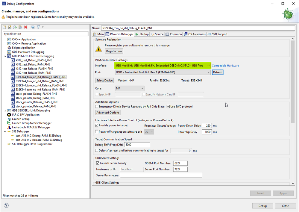

while debudding using Open sda debugger, in the drop down option com port is disbaled.
Evaluation board- s32k3x4evb-T172
Software ide - S32design studio for s32 platform (3.5 version)
Please find the attached .

debugger integrated on S32K34x EVB is Embedded PE Micro Multilink FX:

The board has an open sda port available, how can I use this on board debugging port instead of PE micro debugger?
This evb manual says it allows you to connect your development board to a host computer and use a compatible Integrated Development Environment (IDE)?

Did you tried the option shown above? There is no OpenSDA debugger as is known on S32K1xx devices. There is embedded PE Micro Multilink FX debugger integrated on the board and accessible via Micro USB. But the functionality is same - the micro USB acts as debugger and COM port.
Or may be I don't get the question.
