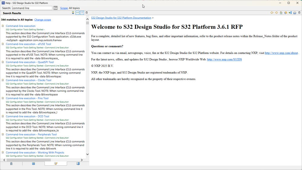

jiri_kral
please use S32DS help - on main menu bar Help -> Help Contents and in search box write command line (or command line build):
