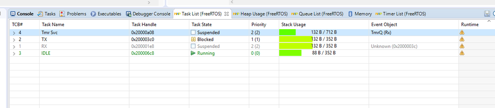

I'm trying reproduce your issue, but no success.  I used FreeRTOS example from SDK RTM v3.0.0. - SDK supports FreeRTOS version 10.0.1 - that's may be cause of your issue.

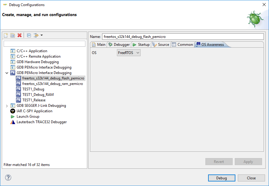

Anyway - I slightly modified FreeRTOSConfig.h (in attachment) and enabled FreeRTOS in Debug Configurations -> OS Awareness.
Task list:

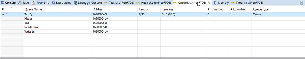

Queue list:
