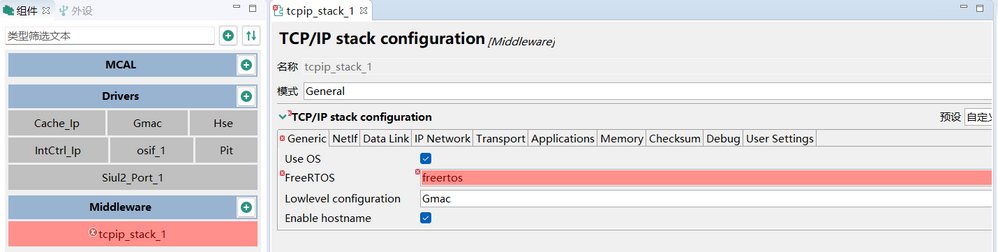

cxc
when i use lwip example code, why i can not select freertos as the middleware?am i miss any step?tcpip.pngtcpip.png
8,740 Views
mikedoidge
@cxc,
Please provide the NXP device and core you are using. Also, please share the 'Installation Details' screen from the S32DS Extensions and Updates menu. Look for the blue text 'Installation Details' to the lower left.
Mike
8,952 Views
jiri_kral
What is your target MCU? Do you have installed and updated dev package for it?
Jiri
