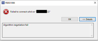

I'm trying to use the S32 Design Studio remotely from a Windos 10 machine to an Ubuntu machine. While trying to establish any kind of remote connection via S32 Design Studio i get an error.
Eclipse Community Forums: Newcomers » RSEG1066 Negotiation Failed
That article says that the conncetion is not possible because the Remote System Explorer plugin does not support RSA-SHA2-256 or RSA-SHA2-512 so OpenSSH does not accept the requests.
Has anybody tried something similar?

I didnt get the time to update the version of my ssh server but i found a workaround by adding some line to my /etc/ssh/sshd_config
KexAlgorithms [email protected],ecdh-sha2-nistp521,ecdh-sha2-nistp384,ecdh-sha2-nistp256,diffie-hellman-group1-sha1,diffie-hellman-group14-sha1,diffie-hellman-group-exchange-sha1,diffie-hellman-group-exchange-sha256
Ciphers [email protected],[email protected],[email protected],aes256-ctr,aes192-ctr,aes128-ctr
MACs [email protected],[email protected],[email protected],hmac-md5,hmac-sha1,hmac-sha2-256,hmac-sha1-96,hmac-md5-96
This works for me now but is pretty unsecure because i am forcing my ssh server to accept outdated ciphers.

I did quick test - and the Remote System Explorer works as expected. I tested it with S32DS foi Power Architecture v2.1:(I'm not sure what's your version).
Is ssh server running on your Linux machine and you are able connect to your Linux machine for example by Putty or WinSCP? Your ssh settings is correct (IP address or host name/keys)?

i'm using S32 Design Studio for S32 Platform 3.5 and my SSH Server on the linux host is working correctly and can successfully connect to it via putty or Windows PowerShell. As far as i know the SSH Server is using the default settings on Ubuntu 20.04. I was able to use the FTP connection on RSE but i need the SSH connection.

thank you for sharing details. I tested it with S32DS v3.5 and ssh connection is working as well. Bellow  is my sshd conf file. You can compare it with your conf file (on my side there is nothing to include from /'etc/ssh/sshd_config.d directory). sshd version is 8.4p1.

Thanks for the help my sshd_config looks identical but i noticed that my ssh version is at 8.2p1 i will try to upgrade it in the next days and will come back to that.
