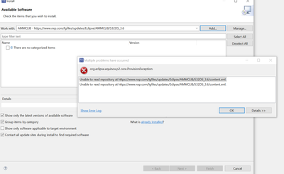

Hello all,

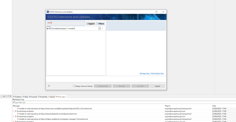

I am facing following issue when try to integrate AMMCLib into S32DS.3.6.2
1. AMMCLib does not appear in the Extensions And Updates and I am getting bunch of errors in the error log
2. When I try to add it manually, via install new software ,  I get similar errors
Unable to read repository at https://www.nxp.com/lgfiles/updates/Eclipse/AMMCLIB/S32DS_3.6/content.xml.
PKIX path building failed: sun.security.provider.certpath.SunCertPathBuilderException: unable to find valid certification path to requested target
Any advice would be helpful! Thanks in advance!

_david_p_
Support for S32 Design Studio 3.6 was added in AMMCLib version 1.1.41, which has been available as update site since July 14, 2025. The latest version is available in this repository: http://www.nxp.com/lgfiles/updates/Eclipse/AMMCLIB/S32DS_3.6
