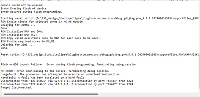

So, there is no problem for S32k324 application project. If I'm trying to flash application project for S32k344 evaluation board then error is occurring. For your reference, I have attached image in below.
But, Same project I was trying to  flash from my colleague laptop then there is no issue. Could you please help me to solve this issue and let me know if you need more information.

Hi @Ajay_R1
Could you help me check if there is any difference between your setup and your colleague setup? Also, does S32DS show any other errors?
