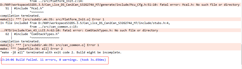

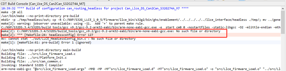

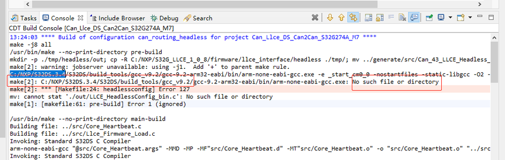

I have installed S32DS 3.5 and S32G-LLCE-GATEWAY_1.0.5, and enabled the LLCE Can's headless mode feature. However, compiling the example program Can-Llce-DS-Can2Can-S32G274A-M7 did not pass, and the error is as follows:
1. Prompt: Can't find the gcc compiler for S32DS 3.4? Why do I install S32DS 3.5 and prompt me to find the gcc compiler for S32 DS 3.4?
2. Unable to find the file "Llce.Headless. h"
How to solve the above two problems? Thanks.

Q2: if the build is Debug_RAM, i get the compilation error as below.

Below will be some comments on regards of your open points:
[DA]: We are unable to reproduce this outcome:
Can you let us know which RTD version are you using?
[DA]: This seems to be a bug under the LLCE v1.0.5 examples. We can recommend updating to LLCE v1.0.6 (or newer), since several fixes were implemented for the newer versions. We do apologize.

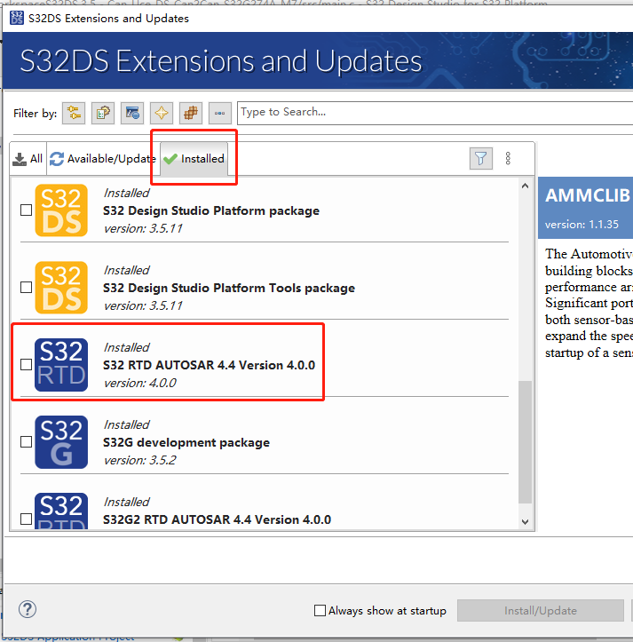

Hi, Daniel-Aguirre
First of all, thank you for your reply.
Following picture is my RTD version number, please take a look:

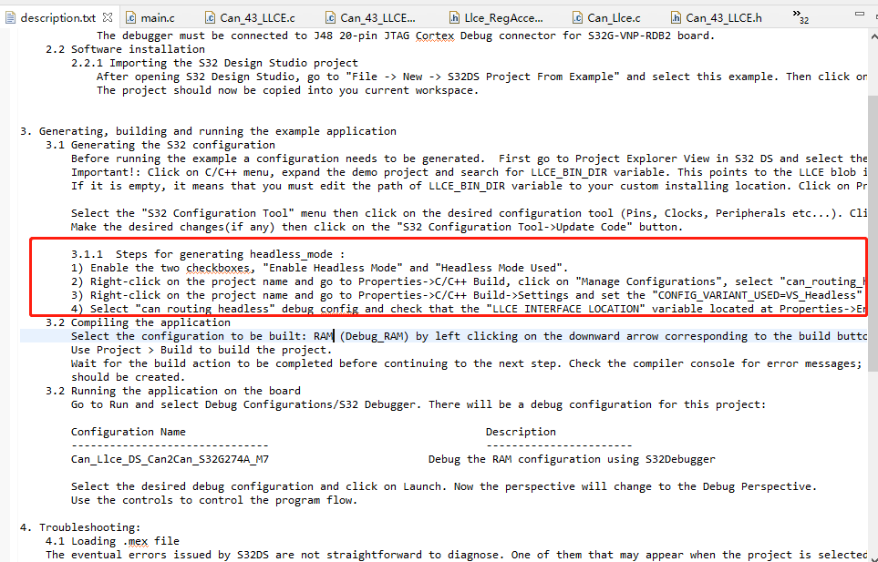

Furthermore, based on your compilation results, it appears that you did not enable the headless mode function. If I do not enable the headless mode function, it is possible to compile the code successfully, and only by enabling the headless mode function can the code be compiled failed.
Please check if you have enabled the headless mode function before compilation according to the description.txt document:

In which all steps were followed as per the description.txt file. We did see the behavior you stated under v1.0.5, hence the previous recommendation of updating to a newer LLCE version.

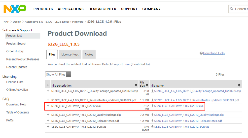

I understand that you compiled the code successfully for headless mode functionality using LLCE v1.0.5 QLP1 software, is that correct? Where can I find the LLCE v1.0.5 QLP1 software? I only found the LLCE v1.05 version software on the NXP official website.
[DA]: QLP1 is provided on a different option, not under the same v1.0.5. You could confirm if it is available to your account under the previous menu that you are showing:
If it is not available, help us contacting your local NXP FAE/DFAE/representative, for them to enable your account (if available).

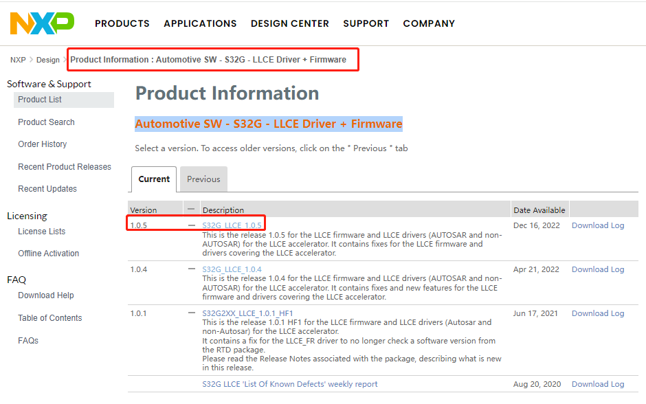

[Daniel] QLP1 is provided on a different option, not under the same v1.0.5. You could confirm if it is available to your account under the previous menu that you are showing
Did you refer to the menu "Product Information : Automotive SW - S32G - LLCE Driver+Firmware" when you mentioned the previous menu ? The previous menu that my account can see is as follows,which seems a little different from your screenshot:

It seems that you account is not enabled to access newer LLCE versions. Help us contacting your local NXP FAE/DFAE/representative, for them to enable your account (if available). We do apologize for the inconvenience.

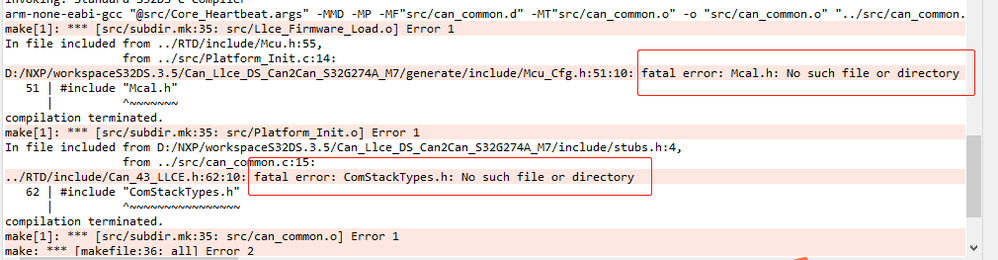

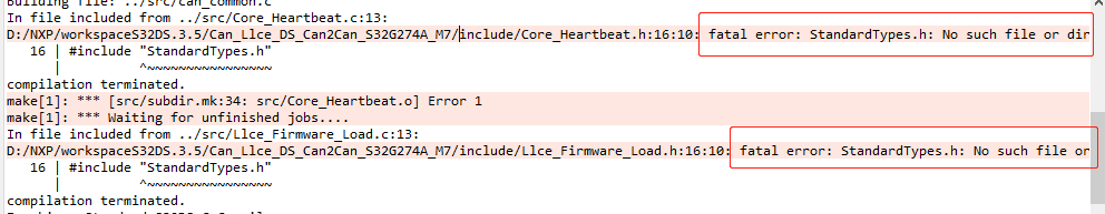

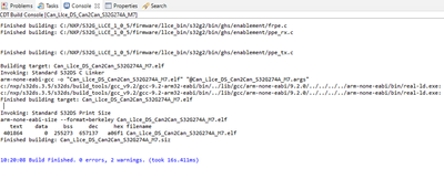

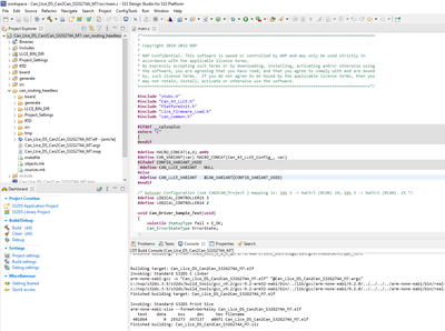

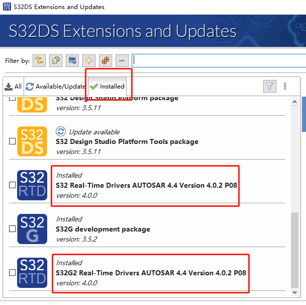

I am able to see and download the file S32G-LLCE-GATEWAY_1.0.8_D2402_DS_updatesite.zip. I compiled the Can2Can example program for LLCE_1.0.8, which enabled the headless mode feature and reported errors similar to those in LLCE_1.0.5, such as still reporting "Unable to find gcc compiler in C:/NXP/S32DS.3.4 directory" and so on. In order to compile LLCE_1.0.8 version, I have updated the RTD version to SW32G-RTD_4.4_4.0.2-P08-D2404, the following images shows my RTD and LLCE versions:
企业微信截图_17176526491325.png企业微信截图_17176526491325.png企业微信截图_1717652612375.png企业微信截图_1717652612375.png
The compilation error screenshot is as follows:
企业微信截图_17176528507339.png企业微信截图_17176528507339.png企业微信截图_17176528979630.png企业微信截图_17176528979630.png企业微信截图_17176529316194.png企业微信截图_17176529316194.png企业微信截图_17176529882893.png企业微信截图_17176529882893.png

Thanks for your feedback. On regards of the S32DS3.4 being looked by your compilation process, might be an installation problem, since from our side we are unable to see any S32DS3.4 being used under S32DS3.5, as told before.
As for the other compilation errors, we are also unable to reproduce them.
Can you help us reinstall S32DS v3.5 to confirm that the S32DS3.4 error is the one causing the other errors?

Thanks for you help, but I don't think there is a problem with my installation of S32DS 3.5 IDE software because I can successfully compile the SDK's flexcan routine and the LLCE Can2Can routine without enabling the headless mode feature. I have installed the S32DS 3.5 software on another computer of mine, and it encounters the same error during compilation.
Does the S32DS 3.5 IDE tool have compilation logs? What kind of logs or other useful information can I provide to help locate the compilation errors?
