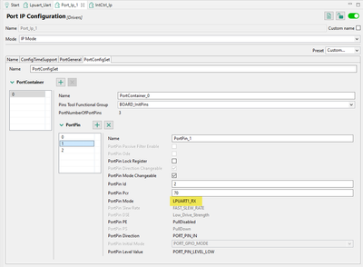

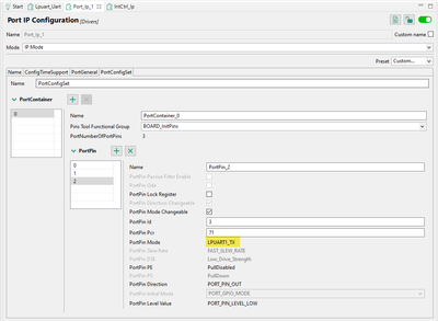

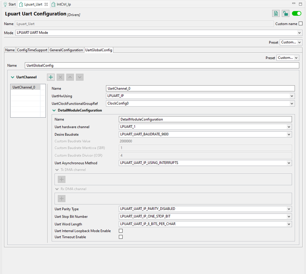

In order to use UART, you can simply add the UART component and configure the pins through Config Tools:
If you want to use interrupts or a callback for your reception and transmission, then the IntCtrl driver must also be added, but for a simple uart configuration that should be enough.

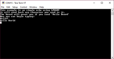

I've attached a simple example which echoes the inputs through a serial terminal through UART1 (connected to the EVB's USB):

I imported the file you provided and successfully received transmitted data in the debug terminal.
However, after following the UART configuration steps to create a new project, I am only seeing ‘NULL’ in the debug terminal instead of the expected transmitted data.
