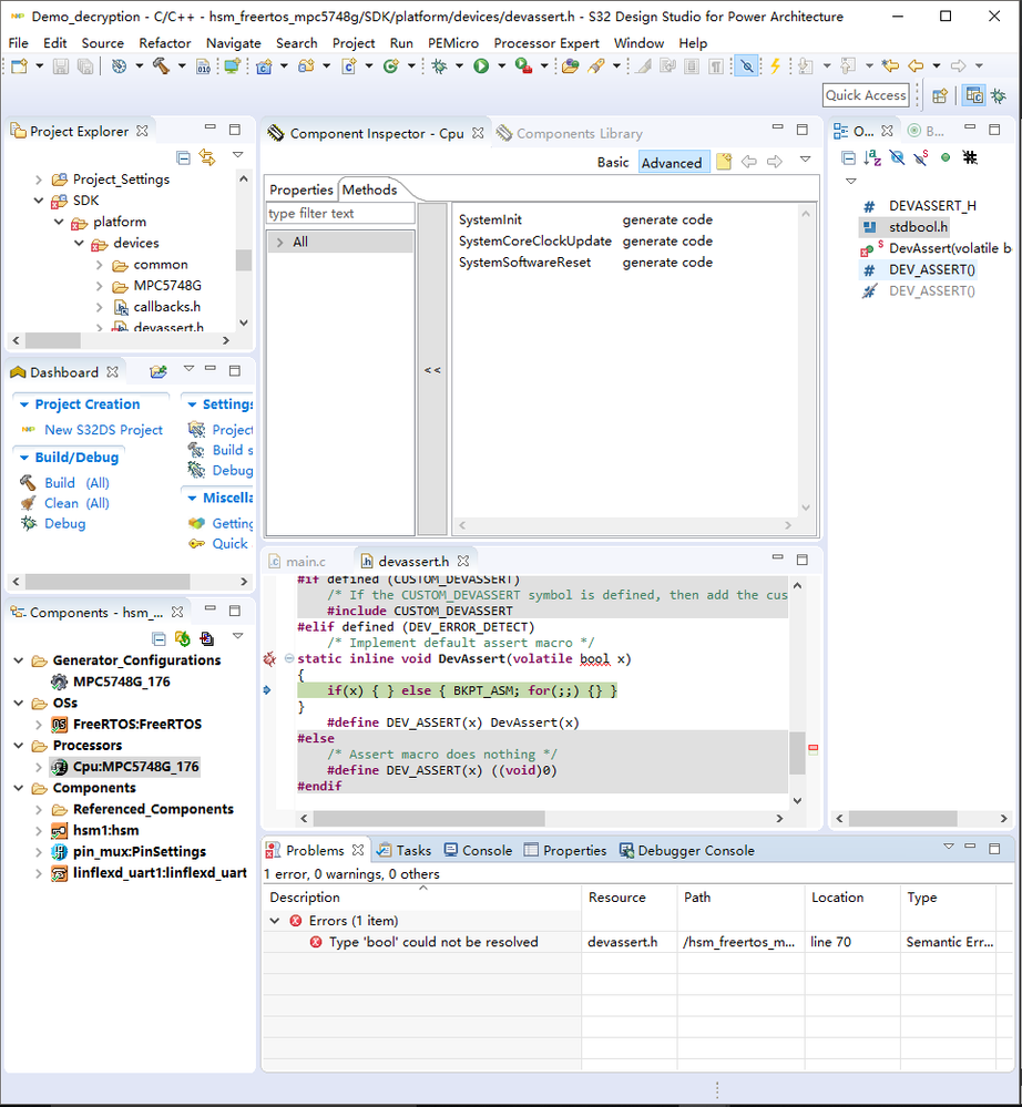

The program I used is the example project with the name of hsm_freertos_mpc5748g. When I try to debug the project, the type bool can not be resolved. I used to method which is mentioned in the https://community.nxp.com/thread/472056, it does not works.  I have no idea to solve this issue.....And how to solve it ?

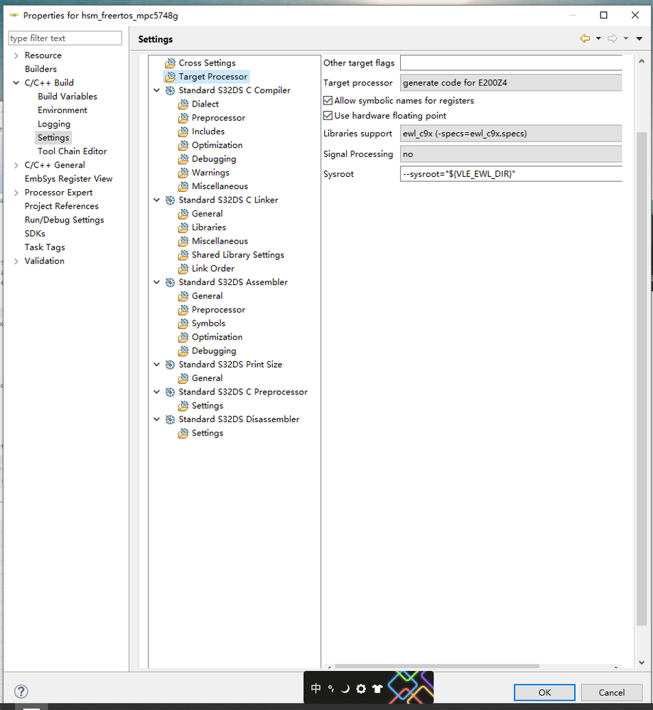

Which C library are you using - EWL or NewLib? Can you please share your project?
Jiri
4,353 次查看
961271210
Hi Jiri,
Where can I find the C library in the S32DS?  I do not find it. The project which I used is the example project from S32, it name is hsm_freetos_mpc5748g, I import the example project from S32 directly and I do not change anything in it. I do not know why I can not upload my project, there is not an option can do that.
Jupeng
4,353 次查看
jiri_kral

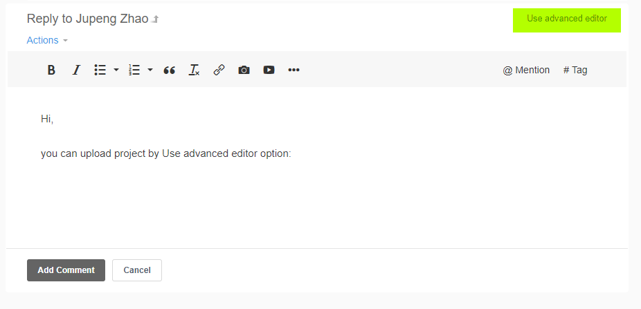

you can upload project by Use advanced editor option:

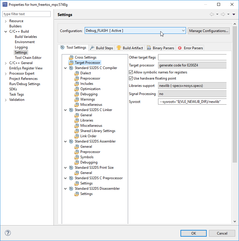

There is probably something wrong with your project settings/S32DS Installation. bool is defined in stdbool.h header file - based on used C library.
You can find which one is used in Project Properties (right click on project name) -> Properties -> Settings -> Target processor:

961271210
Hi Jiri,
This is the C library which I used. And I upload my project.
Jupeng

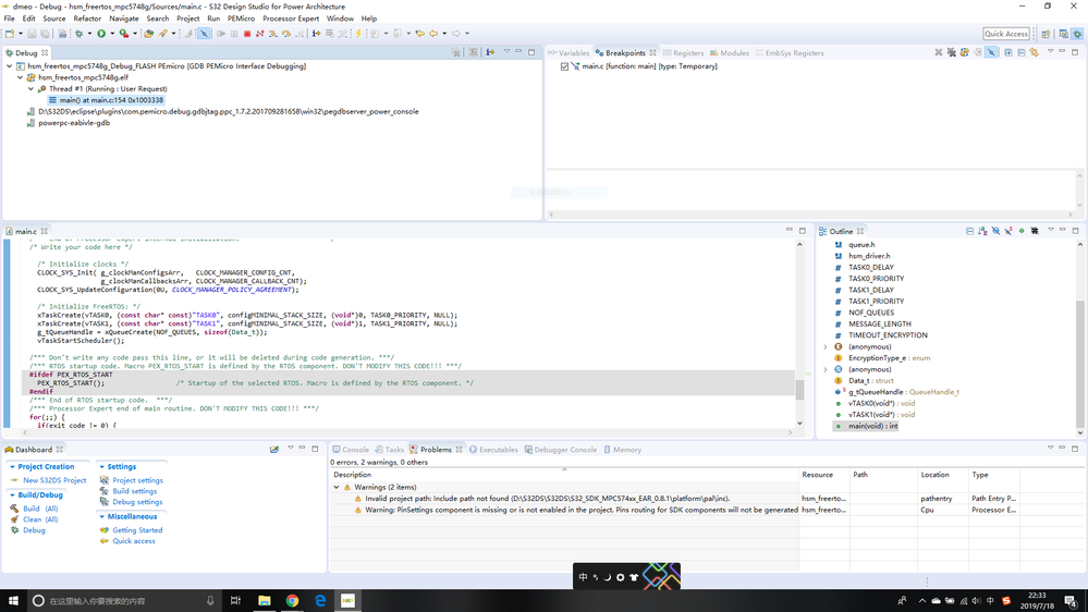

961271210
Hi Jiri,
I re-install S32 in other path and get the following image, it seems there are not any issues. But in this project, I cannot receive any messages from serial port. I wonder if the right result is that the board will send a sentence by serial port ?
