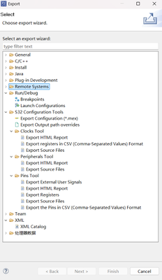

I followed the instructions in "HOWTO: Export S32DS Project to IAR EW (S32K14x/S32K11x)", but I couldn't find the "Project Info Export Wizard" option in "Export".

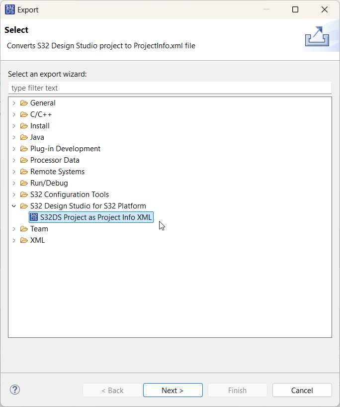

this feature was present in older S32DS with processor expert. I'm not familiar with IAR Workbench, but I assume that you can import project into WB IDE as a ProjectInfo.xml
