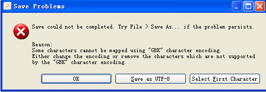

After I write the code,there is a errior shows that"some characters can not be mapped using 'GBK"character encoding"when I save it.
Could someone give me some suggestions,thanks a lot!

About the second problem, could you please send me back some screenshots?

I just changed a little bit of example code,but the file can not be saved.The following picture shows the second problem,

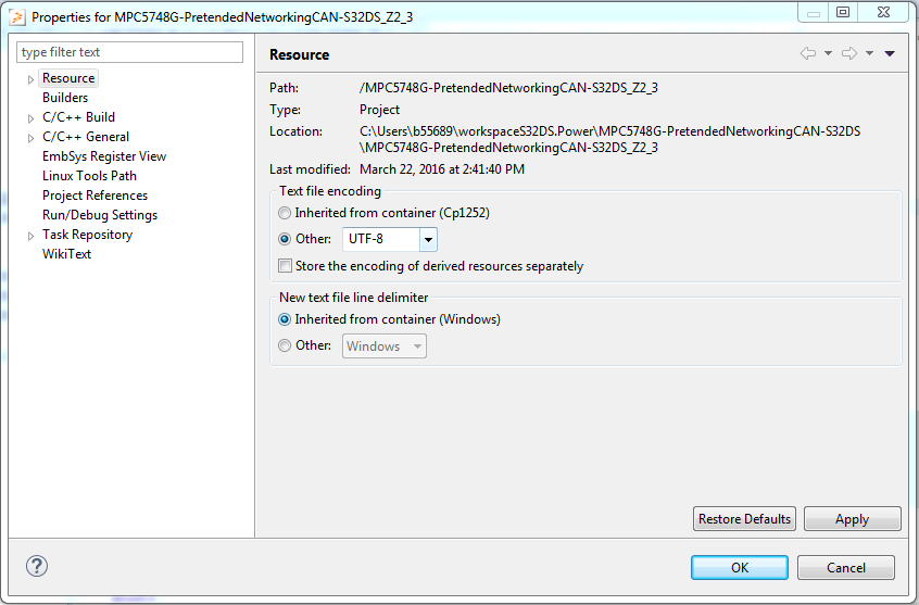

martin_kovar
first idea, right click on the project and in Resources option change text file encoding to UTF-8 or UTF-16. It seems, there is some problem with text encoding and national characters.
Martin
4,132 Views
banzhierji
Thanks a lot,I got it.my problem has been solved.I try to click window->profermance->Genaral->content type->text in turns,and change each  file default encoding  to UTF-8,it seems also can be solved .
